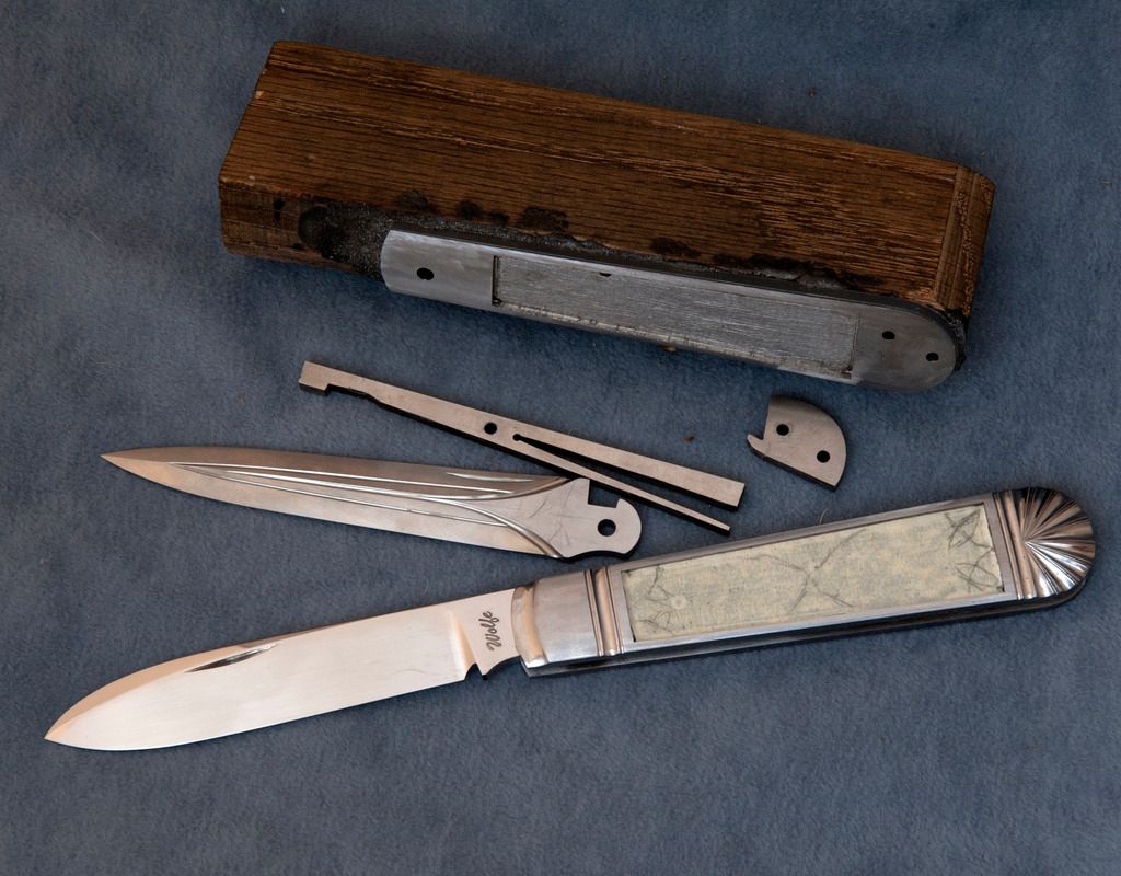

I am starting work on my first solid gold frame folder. This will be a learning experience.
Any hints from those who may have done this are welcome! I am doing a "work in progress" of this and a regular folder on Instagram https://www.instagram.com/wolfgangloerchner/ , so taking photos is prolonging the process. I will check in here as well as work progresses.

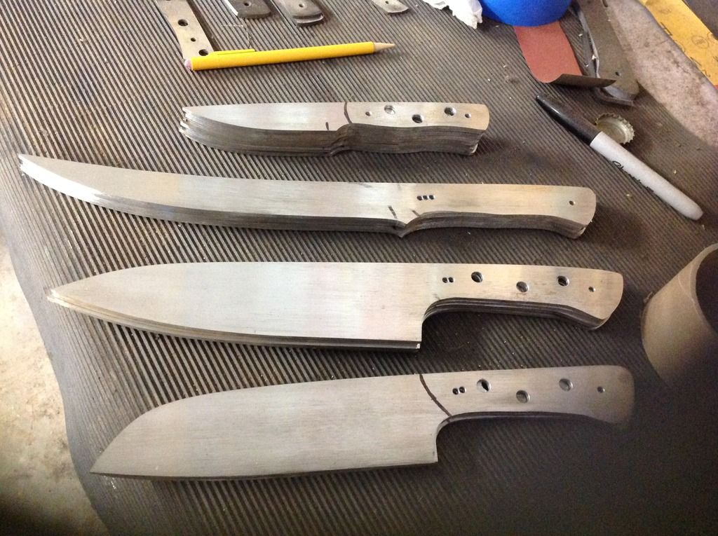

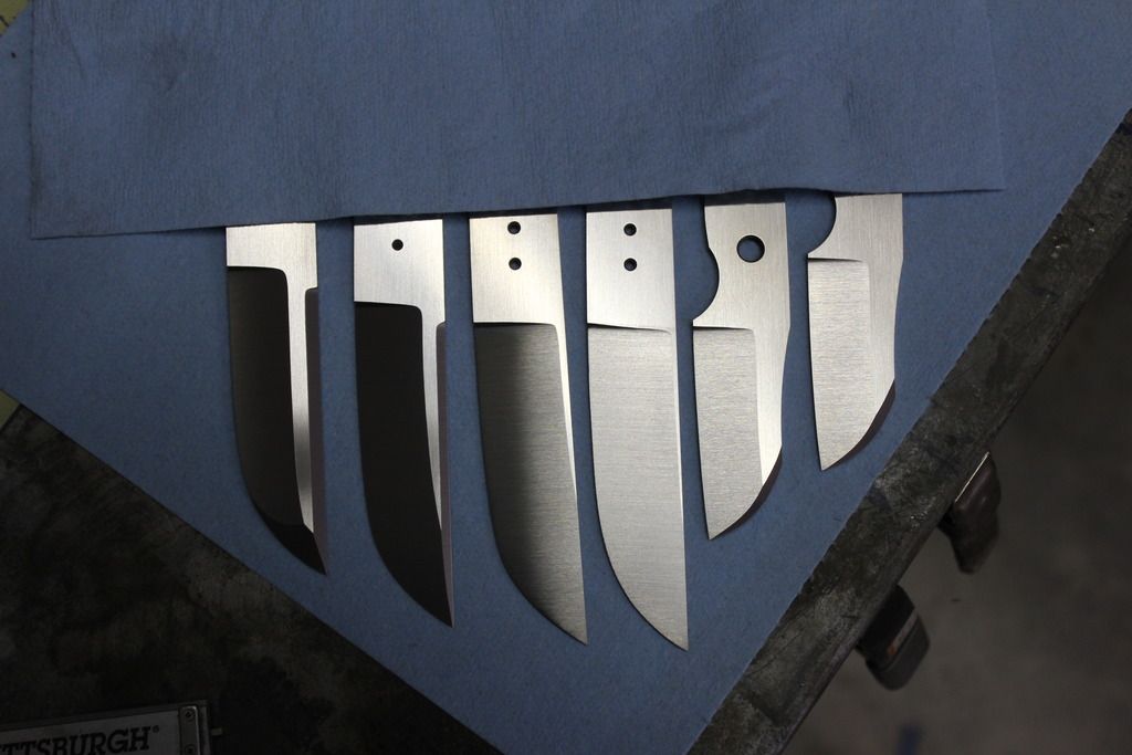

Doing a mix of grinds and new designs this week. Left kwaiken is hollow ground with flat tip, all the rest are flat. Far right kwaiken is going to be scrapped and likely used for edge retention tests. I've only done a handful of hollow grinds but I absolutely love the look of them. I think i will be doing quite a bit more in the future. :D
Great project, Firstly I have not done this but, I have learned from another top caliber folder maker that if I were to do such a project make the parts from nickel and then have them cast in gold. He uses Billanti Metal casting (http://www.billanticasting.com/BillantiCasting/Metals.html)in New York as have I and they do a fine job.

Do you mind sharing how you made that rectangular cavity for the inlay material?
-Scribe the outline of the inlay cavity onto the frame.
-Drill a series of holes to remove the bulk of the material. Use the depth stop on our drill press.
-Chuck a bottom cutting carbide bur into your drill press and connect the holes. This provides a relatively flat bottom, and you can get reasonably close to the outline.
-File the bottom to provide a perfectly flat surface. At the same time complete the filing to the outline.
I glue the frame to a reasonably heavy steel plate for this process. The mass helps in controlling the cut with the carbide bur. Use a small bur to start, the larger ones tend to grab. The results are not pleasant.
Josh RG, Those all look great. I think that any blade under 8 inches looks better with a nice hollow grind. Make some more. Larry
Thanks Larry! Yeah, i feel like most smaller knives are really complimented by hollow grinds as well. Wish I was better at them but one step at a time. Knocked these out today. For some reason the handle shaping juices weren't flowing today. The smaller blades gave me a rough time during the final stages of completion. Glad they are almost finished! lol.
