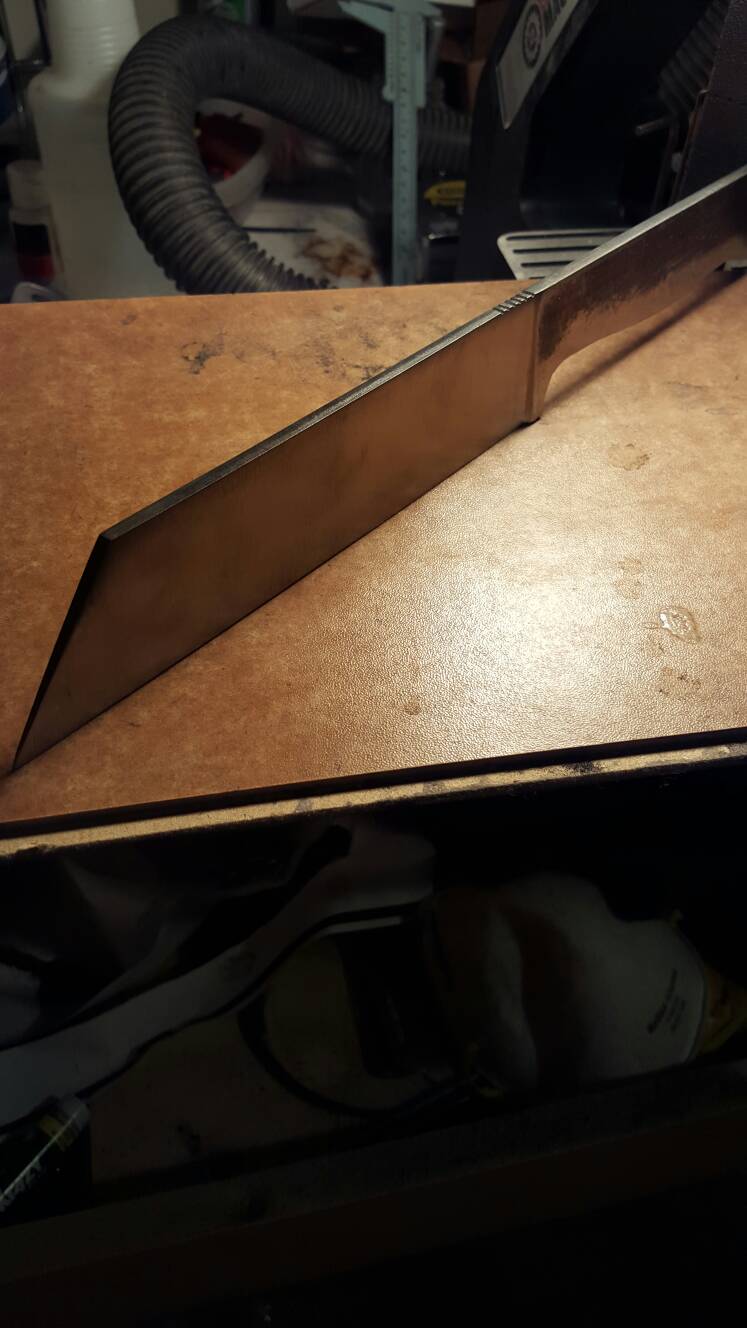

330 Yanagiba
finally finished this one up , i started it in march and it sat on the bench until i felt confident enough to grind it freehand , i originally tried with a board backing but it felt awkward so i discarded that idea , the front face i finished with a 5000gt stone leading into a convexed micro bevel and then sharpened from the rear to 8000gt.
i don't think i will be doing to many of these in the foreseeable future :)

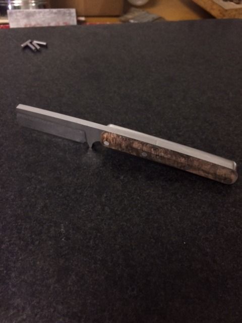

Made this half tang mini cleaver with the remnants of a S30v bar and maple scale I used for the hunter. The stainless side of the scale also takes up the blade thickness to meet the wood scale. All the blades need heat treated which will give me a chance to finish the scales.
