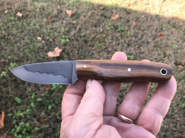

My latest, a San Mai hunter in stainless 420 with 1095 core.
Been a while since I posted here. So, here's one I'm trying to finish up. 80crv2 and curly maple.
Trying to figure out a way to apply aqua Fortis to the curly maple but get it to penetrate very deep and then send blocks off to k&g. I love the way it makes the wood look but it's kind of a pain to use! Also tried tru oil for the first time -- it dries way too fast for me! I have so much cleanup to do now it's crazy...
Got a stencil made but I botched the etch up pretty good. I accidentally moved the stencil while etching... Lol another one for my shop knife pile
Finally picked up a surface plate from Grizzly. Turns out I just can't get things quite flat on my disc grinder. (User error - it spins too fast for me)
