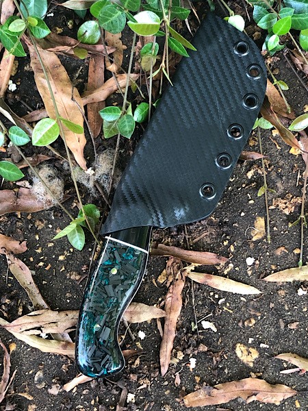

They are screwed together. There are threaded inserts in the CF and the key holes are relieved on the inside like below
Screws are screwed into the scales just over halfway and then head of screw drops into the key hole and can be slid upwards into position. Then screws are tightened from inside with a low profile torx I make
