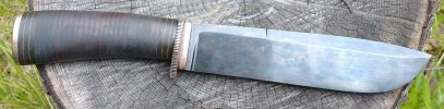

Eric, When using mosaic pins, Always try and "clock" the pins so they are all the same orientation.
A good trick for doing this is to saw a shallow slot in the end at the orientation you want to be the 12:00-6:00 o'clock line ( thus, "clocked"). This will assure that the pins are all oriented the same when ground flush after assembly. The slot also makes it easy to turn the pins during glue-up.
