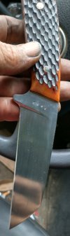

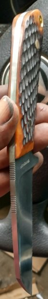

Ground off too much off of the front of the scales after drilling the first holes. Had enough scale of on the bottom and just pushed it up and drilled new holes. Filled the rest with dummy pins. 😂
I also like the look 😁
I'm glad you posted it because I have a couple of blades that something went wrong with and I have to grind them down but now my pins are going to be in the wrong spot and I have been scratching my head about how to make it work out. I'm going to be using it for sure myself.
Yeah, my blades usually dont exactly turn out the way i designed them. I have been working more meticulously lately, trying to keep evetything straight and square from the beginning, scribing lines and grinding accurately to the lay out. I am getting there slowly, but sometimes adjusting the lines with the grinder instead of the pen gives me the right flow. Its for sure easy to get carried away 😅
