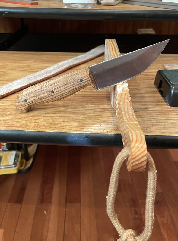

because the titanium is so flexible and springy- and I've built a two handed handle which will allow a significant amount of power to be put into a cut- I was feeling a little wary of the handle slabs peeling off the tang. The Terotuf slabs are glued to nice thick vulcanized fibre with gflex + toughener, and to the tang with the same stuff. The brass pins were turned down to size with a rasp and have deep circumferential scratches that I hope some epoxy stayed in when I was pressing everything together. The turk's head knot at the front of the handle is saturated with gflex as well and I tied it super tight. Anyway, still not 100%, I tapped the pins today and countersunk the bores enough to get these aluminum bolts in nice and flush. They'll be epoxied in there permanently. If all goes according to, well, whatever it is I think I'm doing, this should be a pretty bombproof handle.
Borrowed a fellow knife makers Scotch-Brite belt (it's the first time I've used one) I'm definitely going to have to get me one of these!View attachment 1651654
