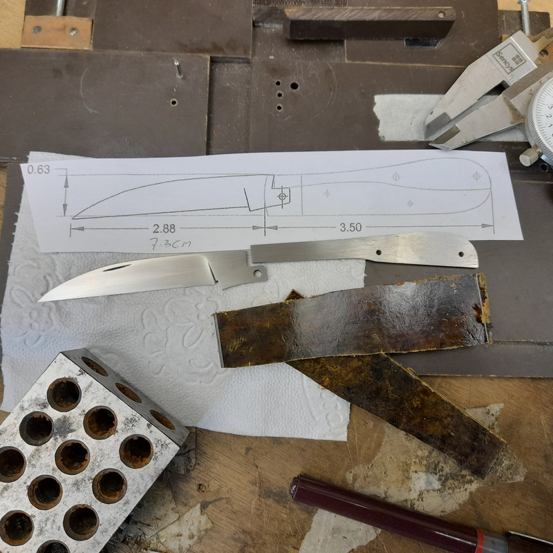

RWL34 that I bought flat ground and a template from Chris Crawford's website. Also I'll be trying out some rag micarta I came across.

@Natlek as for the grinding i tried grinding the flats with a magnet and 120 belt to a nice finish and the new Bora ceramic belt was just sliding over them. I think the surface is too big to put enough pressure, haven't tried the bevels yet, but it should go easier i suppose.
If your steel is hard enough that you are having problems cutting put on a new sharp belt and turn down the speed and give it more pressure. You are right about the surface area. I bought some 1" belts by accident and they work great for hard steel. So long as you have a sharp belt it should cut just fine. I'm grinding 66Rc M4 and it works just fine. If you go to fast you will take the tips of the belt and it won't cut as well. There won't be many sparks it will just cut shavings off. If you hollow grind its even better or at least hog off the bulk before switching to a flat platten. You will find a sweet spot with speed. If you dig in with an edge you might dull the belt and just switch to a new one. The belts will still be almost new and you can run them at high speed on something softer there will still be a lot of life left. If you are careful the belts will last a surprisingly long time since you aren't breaking down any of the grit or glazing the belt. At least thats what I learned for grinding really hard steel. It works on softer stuff as well.
It was a big learning experience for me. I started out trying to run everything at really high speed to cut the hard stuff and had a lot of problems. Ita just hard to get enough pressure in for the belt to cut well at high speed. I think that concept of pressure and grit size and how it cuts vs wears also applies to sharpening and explains why lower grit edges last longer since they don't fatigue the edge. At least thats how I understand it.
