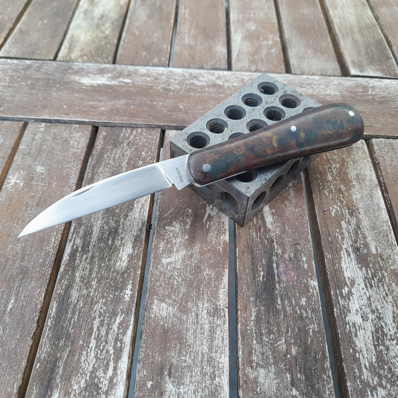

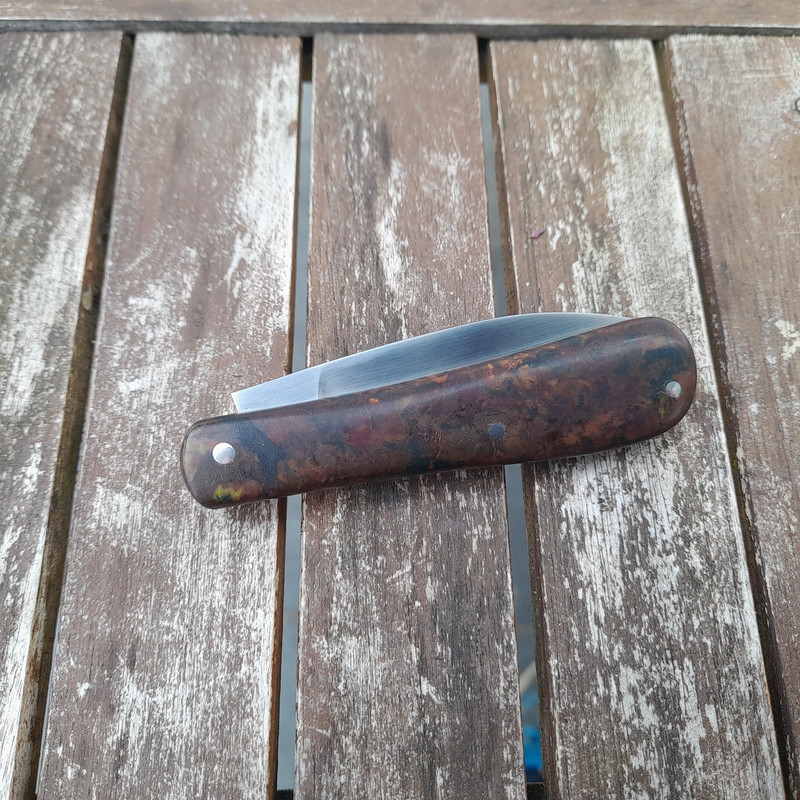

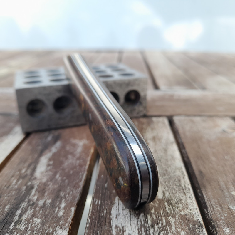

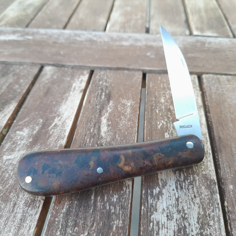

This is slipjoint #7, my first warncliffe.
I'm technically content with it being my 7th slipjoint. Designwise I've learned the I like the point to be lower than I have on this one and that the width ratio between the blade and the handle could have been better.
I've used east-German, DDR rag micarta as handle scales and I'll be using more of that!
