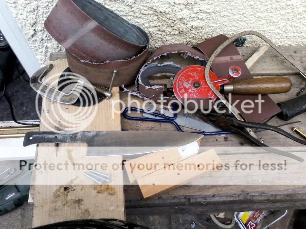

My saw blade kitchen knife I started a whileago, got some shapeing and cleaning done, rough ground and ready for handling.
Got some yew to cut to shape and thin out, then it'll get glues and clamped for an overnight dry!

Sadly my belt sander crapped out on me today, I think I can repair it but I really need to invest in a bench mounted belt grinder. I have no garden or shed so space is limited but I will find a way! XD

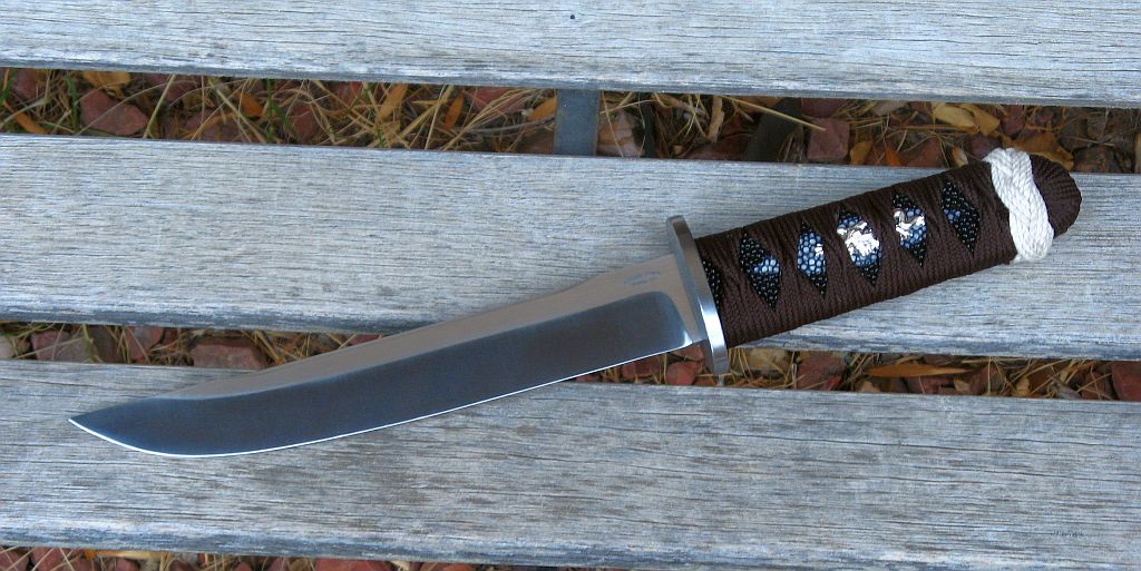

I am finishing up on this bad boy...
8" S35VN blade with a hammered finished guard and some sting ray and silver dragon menuki.
Finished wrapping the handle last night it took several hours but came out nice.

That it one fine looking Tanto and it looks even better to me personally because you made it with a traditional tip and length.

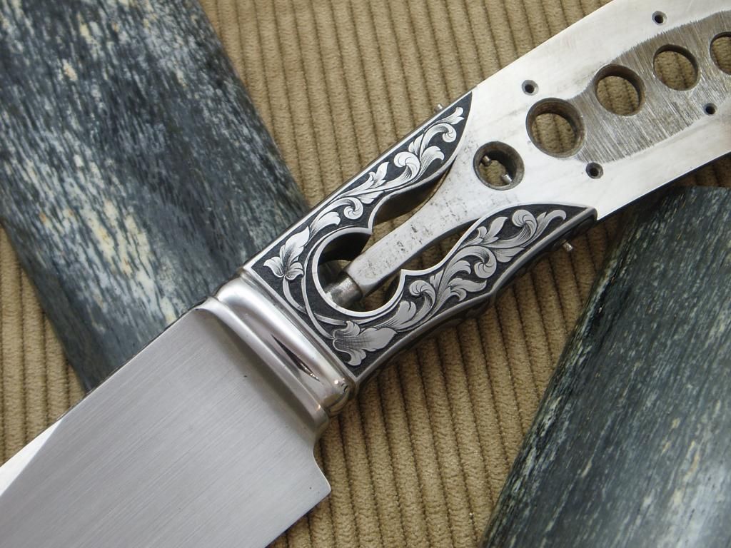

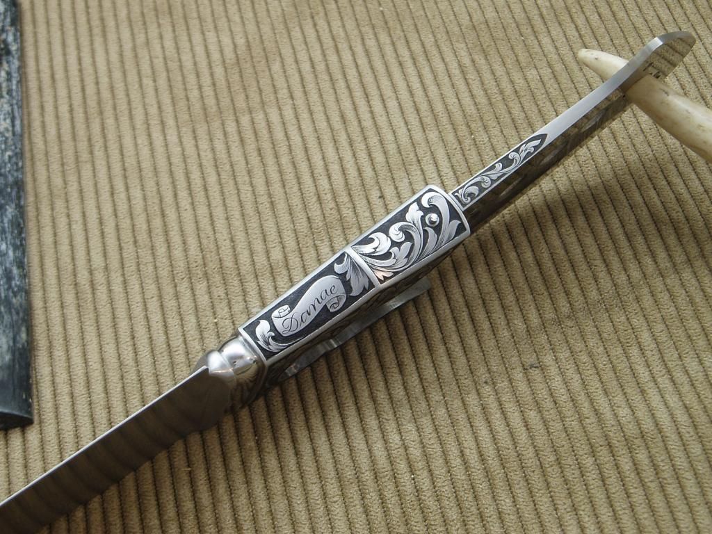

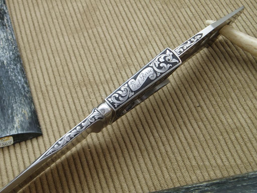

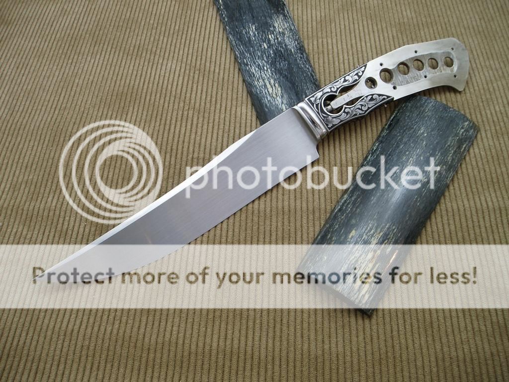

From a few pages back, keyhole integral with the engraving for those that asked. Engraving is by a very determined young lady in her early twenties named Danae Cresswell. Thanks for looking.

I figured it was time for one with the traditional tip on it :)
