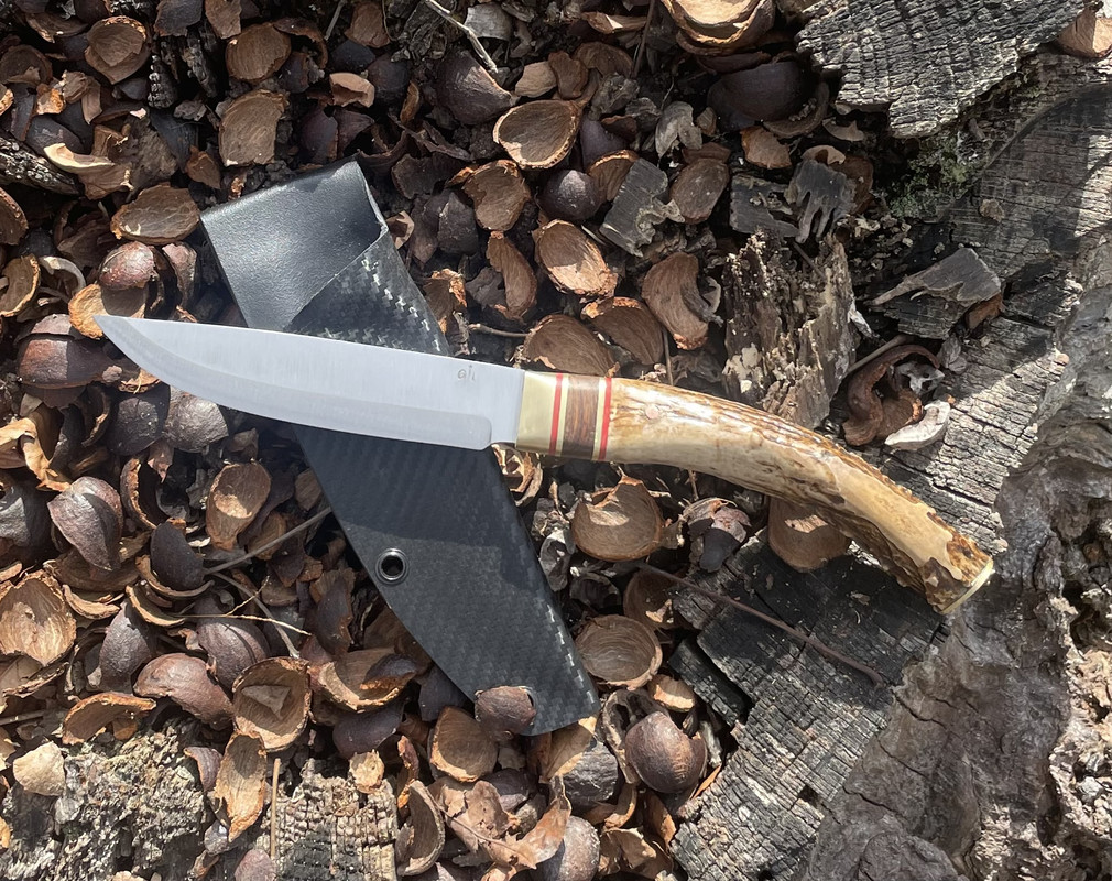

This Stag Hunter is one of my recent projects. It has a 26c3 carbon steel blade. The handle deer antler with a brass button guard. The spacers are G10, brass, and desert iron wood.

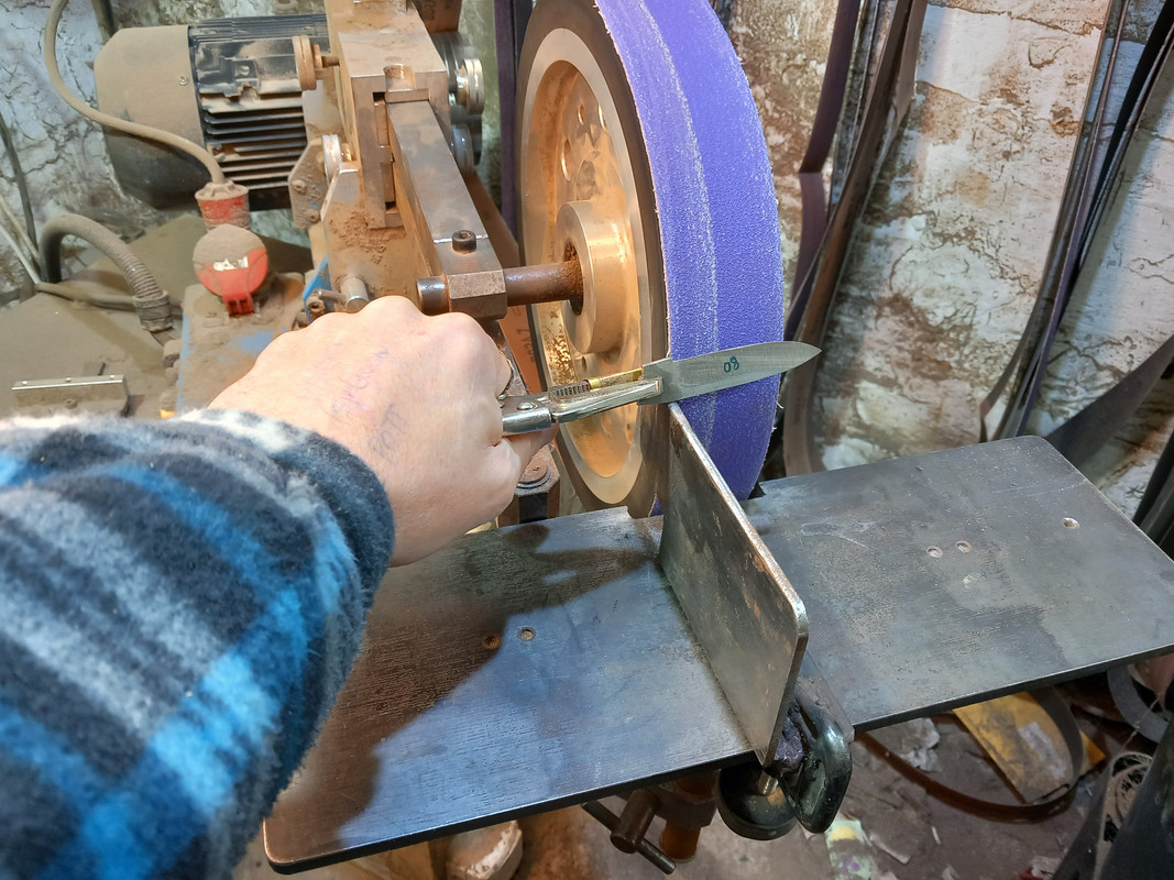

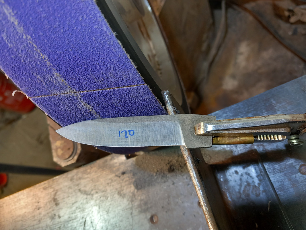

I made a grinding rest like Meades shows in a youtube-vid and I realy like it! It supports but also gives freedome to hold the blade at any angle you like.

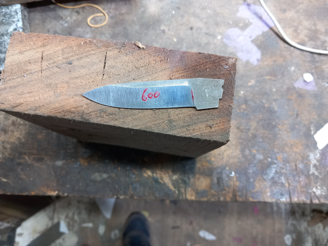

I got six slipjoint blades back from HT plus four practice blades.
I did this practice blade yesterday and ground a real one today. I'm happy with this one, the grindline is even and she is nice and thin, app. 4/1000"
The brown handle is temporary, she'll get jigged bone scales.
