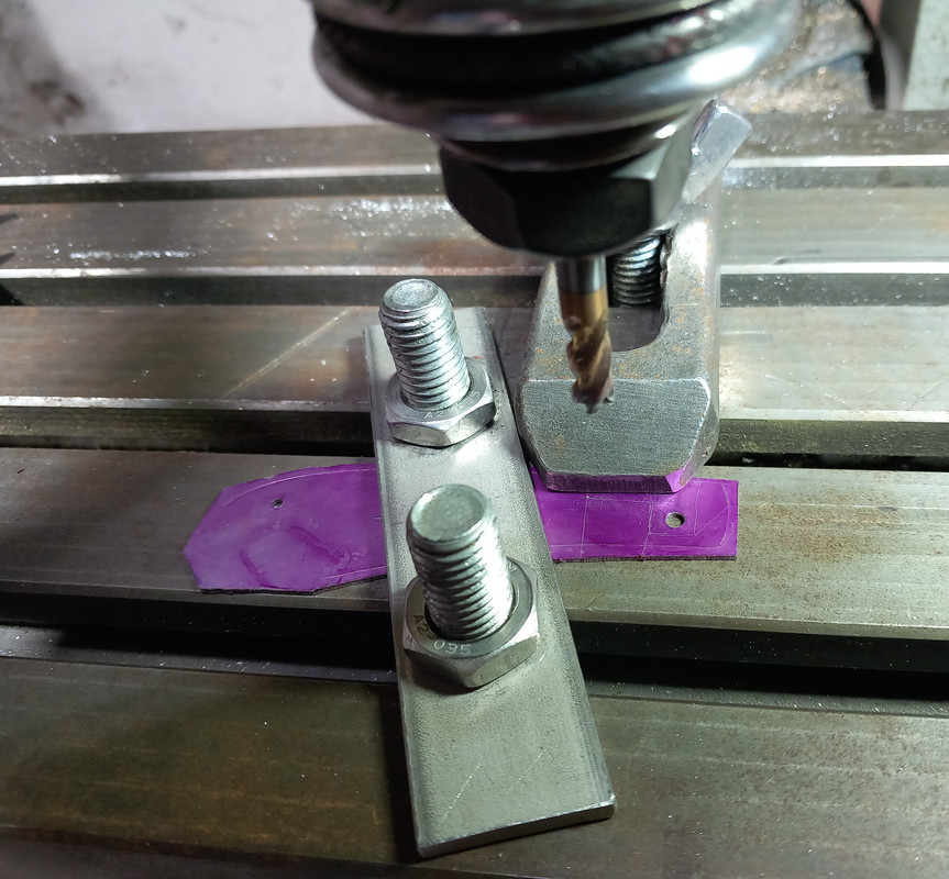

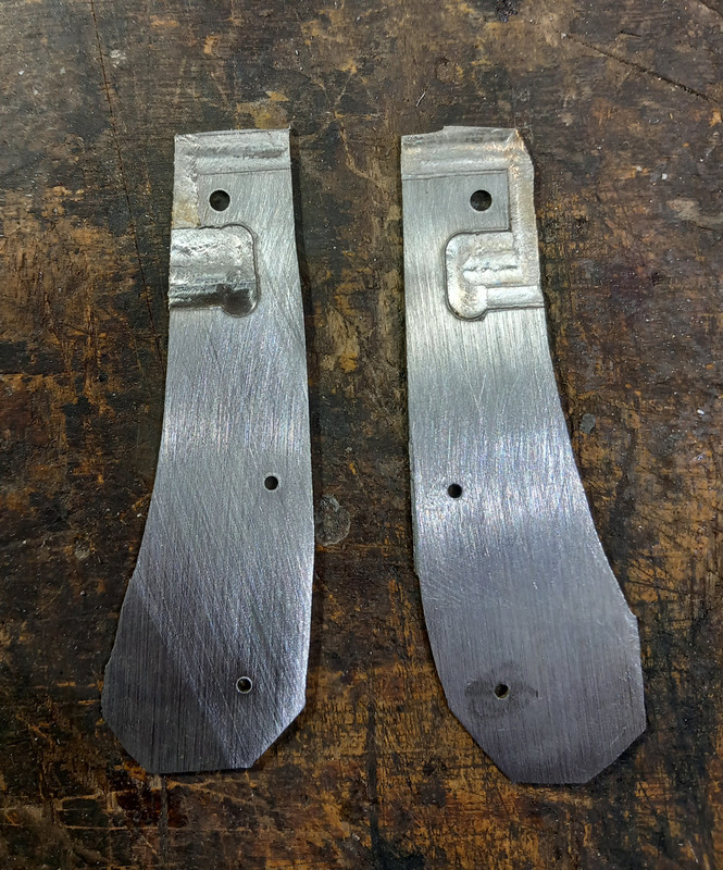

Relieving the liners with a pantograph is a bit different, but I'm happy with the result

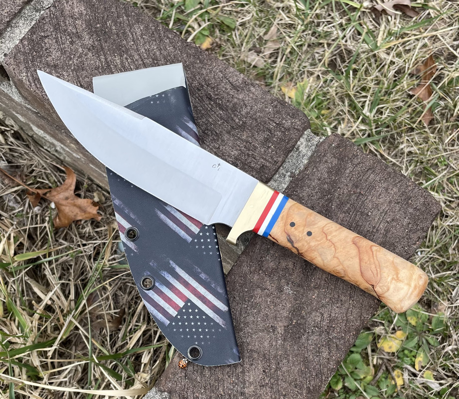

Thats Gorgeous. Great Job!Here’s one I finished up yesterday. The blade is 26c3 and the handle is burl wood with a brass guard and G10 spacers.
Thank you! I really appreciate it!Thats Gorgeous. Great Job!
I actually started tapering my liners out of function. I got tired of shimming my handles to drill the holes when I tapered my tangs and I thought “well I’ll just taper the scales while I’m setup and I won’t have to mess with shims.” As I was getting everything ready the first time I realized tapering the liners would probably look interesting and still accomplish the same thing. It was really more trouble than it was worth when I first started doing it but I liked the look too much to quit. Needless to say it’s much easier to do with my SGA. I do it on all of my tapered tang knives now. After I taper the tang I just stick the scales (double sided tape) liner side out on a couple of pre-ground pieces of flat stock and taper the liners. You just want to check frequently towards the front (thinnest part) to make sure it’s not getting too hot. Then I even everything up on the disk sander. Whole operation takes about 15-20 minutes.Killer handle! Coke bottles are just about as sexy as it gets.
Most folks would have left the red liners even, but your reverse tapered liners accentuate the tang taper, The effect is superb.
