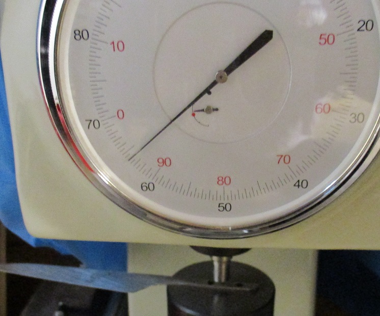

Just took this picture of my aebl paring blade at tempered (not AQ) hardness. Recalling this thread - http://www.bladeforums.com/forums/s...-quot-paring-boning-knife?highlight=aebl+64rc
I stopped update this thread because lacked of interactions. I made a large batch of paring blades with AQ hardness 65rc, some hits 65.5rc (reading is average of 3 readings in 3 different places on the blade - tang, mid, tip). I tempered down to 64rc before post-ht grind the blade.

Although, I've made a large batch of aebl paring knives at 63-64rc working hardness. I am looking for way to produce aebl blade with working hardness at 64.5-65rc. If I succeeded, haha-sad batch of unsold aebl knives get new home = recycling bin.
that's cool, ive seen 64.5 or so but not 65 but I haven't tested hem all either..Good numbers there..
I use AQ or peak/max hrc as a pulse-check, sort of like first level QC. Ultimately, hitting +-1rc targeted hardness for intended-use is the gate keeper for shipping knives.
