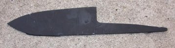

WIP: Heat treatment #3 (cpm-m4 petty blade)
Wrap in 2200F stainless steel foil to minimize decarb & scaling. Double fold seam. I also put some wood shavings in there to burn up oxygen.
My mobile ht oven.
Will soak 7 minutes at this temperature
OK, it warped X & Y direction.
The stainless steel foil is almost 100% welded to the #3 blade. #4 blade also got ht at the same time, it came out 99% clean (no welding/lamination).
After three tempered at 1025F for 2 hrs each time. Obviously I was greedy with 65RC - silly me for extra heat probably caused more problem than I envisioned. I peened straighten it while at temp between 800-1000F. It's now some what straightened - more is needed. Power company has a planned power outage for the next 2 days, so straightening will have to wait.
Done some sanding (no fun here). This welded/laminated will be extremely painful to remove.
I want to start over but I am out of cpm-m4. But I don't want to active the alternate #2 (52100 utility) yet. I have 2 days (without power) to think it over and maybe see how far I can clean up the blade. btw - 60 grits sand paper is hopelessly slow. I'll try 60 grits Alox stone tomorrow. Hopefully this manual clean isn't for nothing because there always a possibility that peening the blade would snap or crack.

That's really hard work and thanks for sharing the process!
I feel for you on the power outage :(
To clean up, possible using DMT XC?
