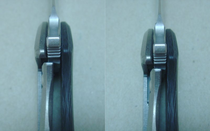

Here's the lockup on mine. Left is the "normal" lockup -- flipped open, and then given a hard grip in hand, just to move the lockbar to where it might end up under normal use. Right is me deliberately trying to force the lockbar to the other side by specifically pinching the lockbar and opposite scale and pressing hard.
Lockup is solid (no lock rock / blade play) in both cases. In the latter case, the lock does become more difficult to disengage, but is still possible. Early or late lockup is fine by me as long as it is a solid and secure lockup. Should the lockup ever wear such that there is lock rock or it no longer stays locked when open, then that's what warranty service is for. That's just my take on it...
Deliberately forcing the lockbar over isn't unique to my 0452CF. I can do the same with any of my framelock or linerlock knives if I make a specific effort to force the lockbar over.

I can force any of my liner lockers and any of my frame locks, over some with finger pressure, but it's just that, some is all not all the way to the non-locking side. It just seems to me when a lock bar can be forced over that far, (with finger pressure) things just aren't as tight and well fitted as they could be. Maybe it's fine and ZT considers this to be normal, IDK I sent them a link to this thread and never heard anything, so far. I doubt they will issue a statement here being they left for good it seems.

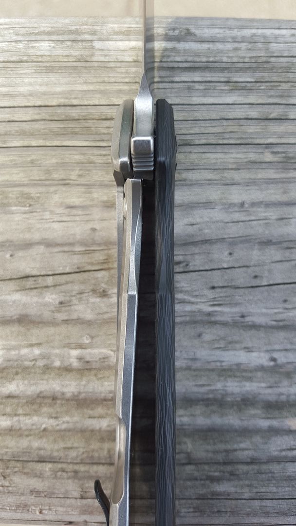

It's great yours is that tight, mine and some other people's 0452's go all the way over to the CF scale when pressed like that (and stick badly). Would you still be happy if yours did?
