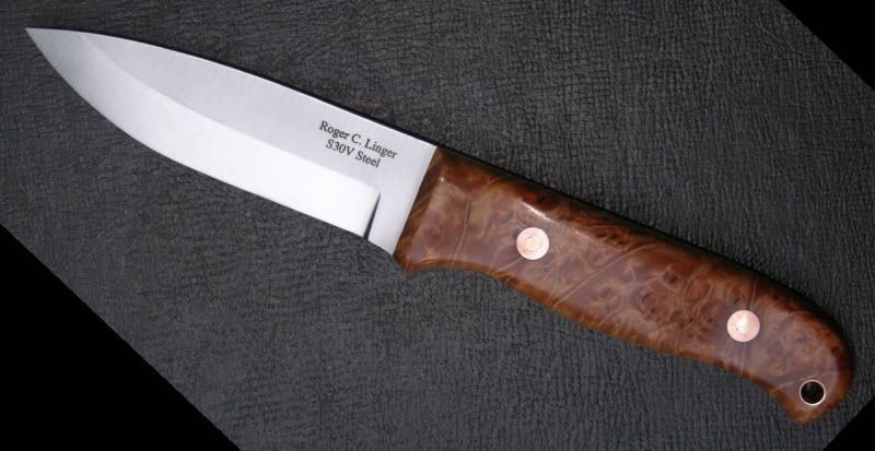

Maybe have a full flat grind right to the spine.
Full flat right to the spine would be my ideal grind. IMO of course;)
Yeah, same here; on thick stock (1/8"+) I feel you have to grind it high so it won't drag/bind up in the work. With decent steel/HT I don't think you lose any appreciable amount of toughness by doing that.
One of these days I want to make a set of identical blades and grind the bevels differently... full flat, sabre, convex, hollow sabre... and compare them... but that's a project for later on...
To me this knife with 1/8" full flat ground stock with a distal taper to the tip, out or 1095, or O1 and loveless pins would be the perfect blade. Add some good wood scales (curly birch, dessert iron wood ect...) and a good leather pouch sheath. Blade length about 4" to 4-1/2" would be perfect. But if the majority wanted a 5" blade, I would still buy it in a heart beat.
NWA..... what do you think?????
Thoughts everyone else :)
Thanks for looking at my work guys. I like to hear peoples opinions of my work. I do offer a bit different knife for $100.00, I have thinking of raising the price though to $125.00.
It is the top knife. This is a set I sold to a fellow BF member out in Oregon.
Nick
I LOVE THIS IDEA!!
Either one of these would be my vote. I like the flat grind, temper line, solid handle, the idea for the firesteel (could we not do a purchase of one type of steel especially for this project?) and sharpener on the sheath! Actually the only thing that I would change (other than the exchange rate to get it here) is that I do not like the very small choil at the base of the blade- but I put up with it in almost all non puukko knives so no big deal!! For some reason I am not a fan of the scandi grind Linger knife above- don't know why but it just does not do it for me (just my 2 cents- not an attack on the knife at all)
