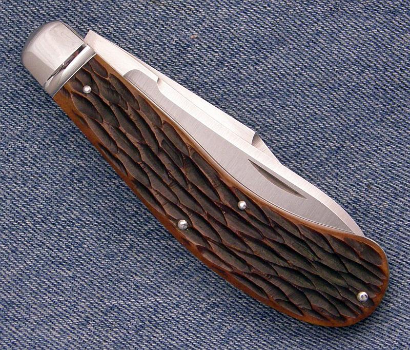

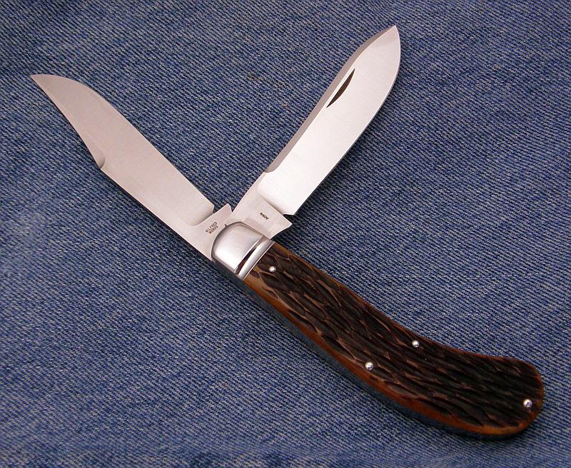

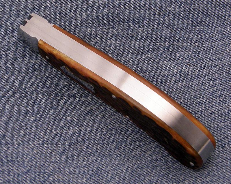

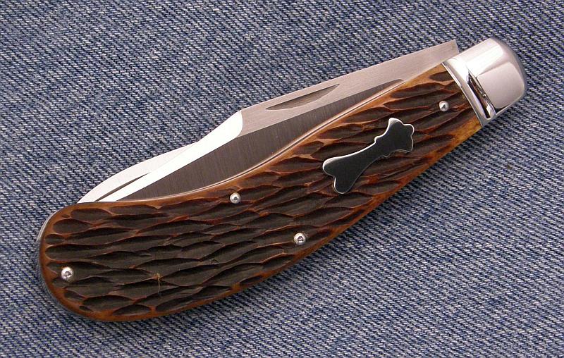

This bone one-of-a-kind(for now) 2-blade modified saddlehorn trapper is sporting a prototype blade combination. This is the first saddlehorn that Tony has put his semi-skinner blade in. Very coarse jigged chestnut colored bone,
CPM-440V Blades, SS rat tail bosters, and SS pinned bullock shield.
That pattern, and the semi-skinner blade were MADE for each other! They fit together so well it's . . .well . . .it's almost indecent!!:eek:
:D:thumbup:

:eek:WHAT A BEAUTY, TONY!!!:thumbup:
LOVE THE PROTO BLADE COMBO!
THANKS FOR THE LOOK-SEE, KERRY!;)
Kerry,
Great Photos! I really like the "Rough bone jig", and the swedgework. Guess thats what seperates the Men from the Boys! :D
I think that the modifies second blade is a Winner!:thumbup:
Kent
Awesome knife :thumbup:

I have never been a big fan of the saddlehorn pattern...until now, that is. Wow!
