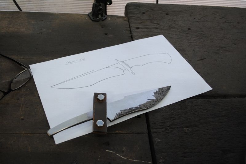

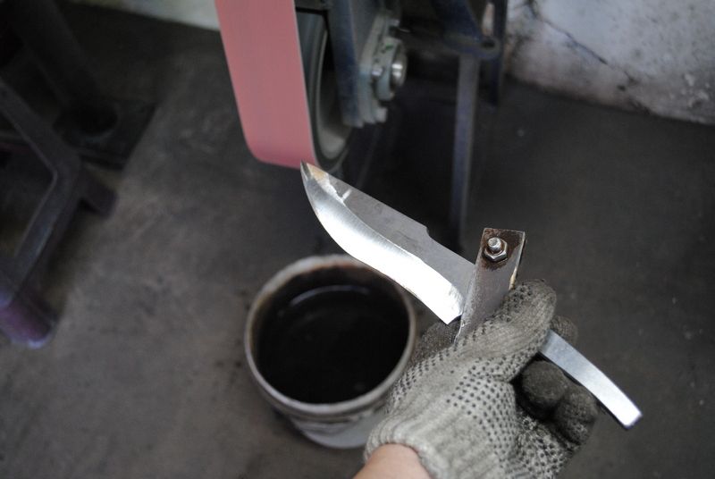

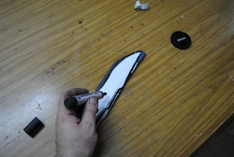

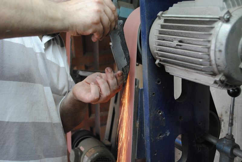

Here Claudio traces the template onto the rough forged blade
He then profiles to shape

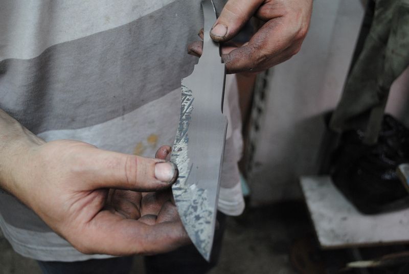

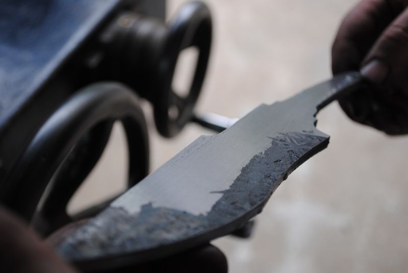

Into the Etching tube

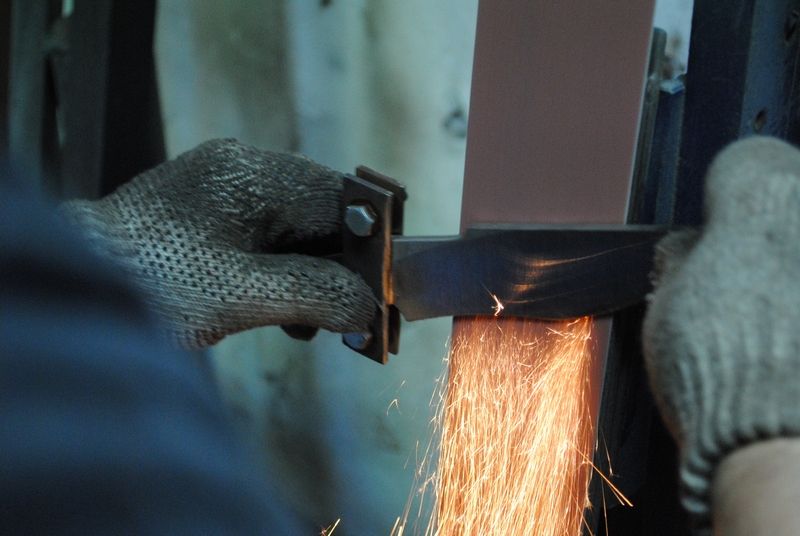

Here you can see the High Carbon Core in the center

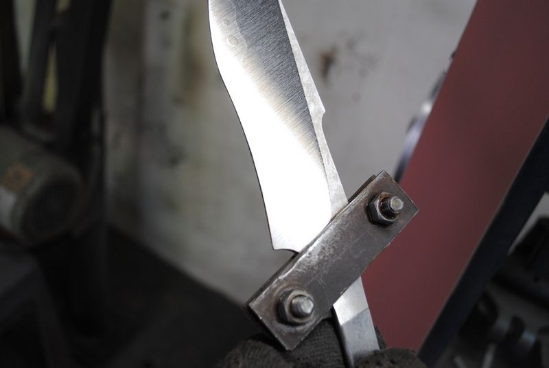

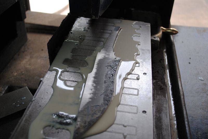

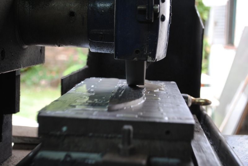

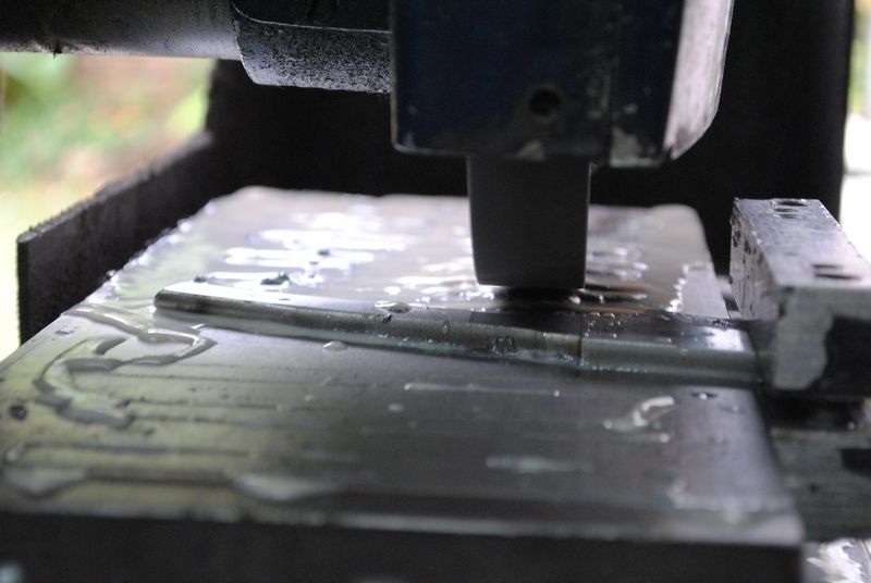

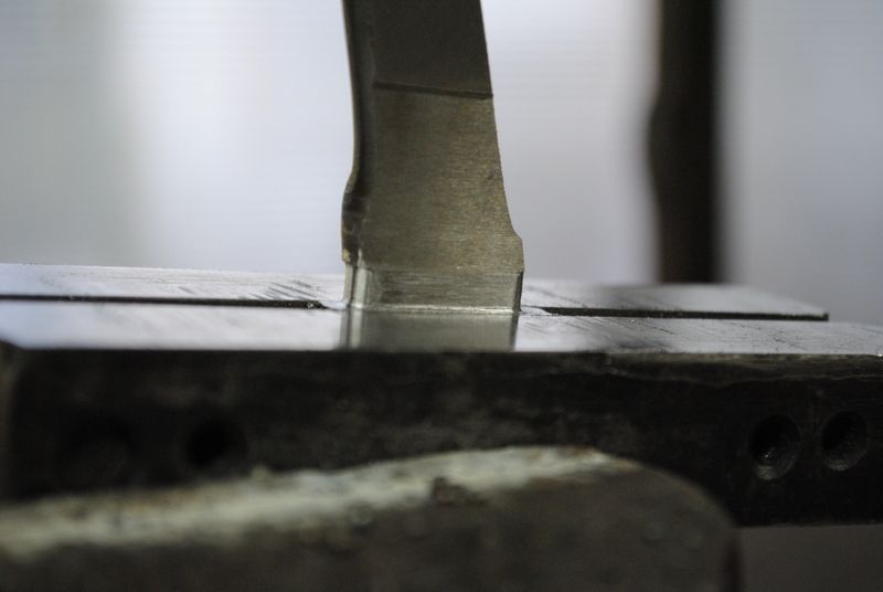

Onto a different Surface grinder (Trying to show off Mr. Sobral?)

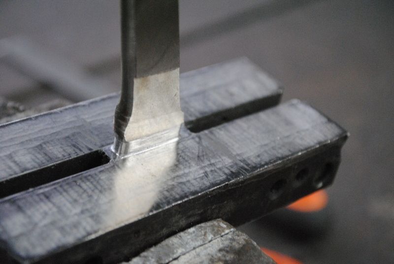

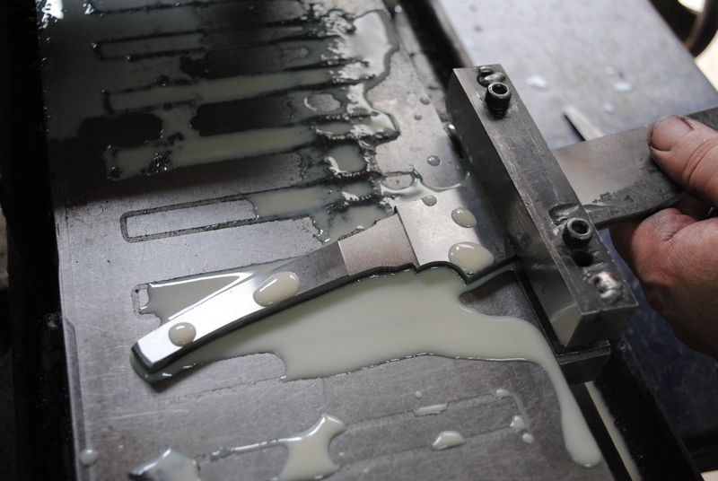

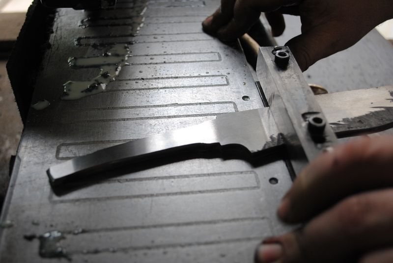

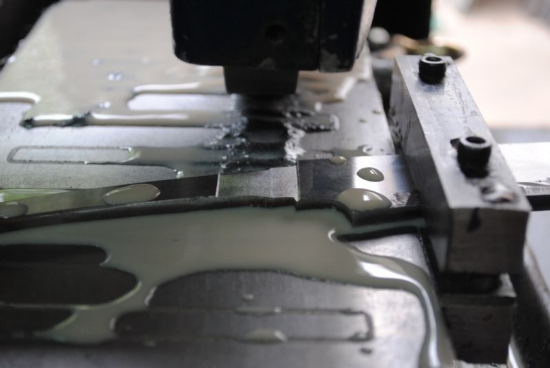

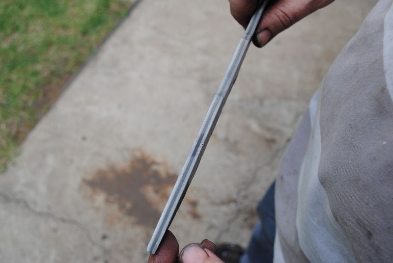

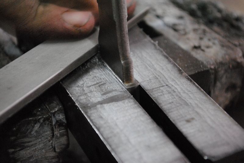

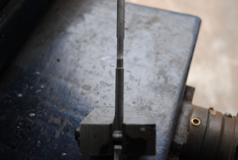

Here he uses another surface grinder to make the shoulders for the guard. Claudio does his guards a little different than I have in the past. He puts shoulders around the entire stick tang, not just on the top and bottom. If I had 2 (possibly more) Surface grinders I might do the same thing!

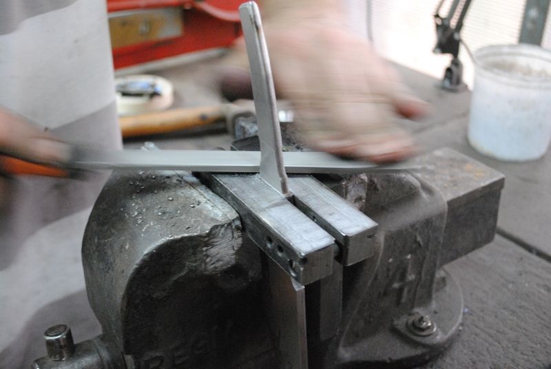

Something I noticed... It looks like he is using the file guide as a vice and to maintain the proper angle of the guard. for the surface grinder on the tang flats?
Now he has moved the file guide even with the shoulders he just made and works on the top and bottom shoulders with a file.

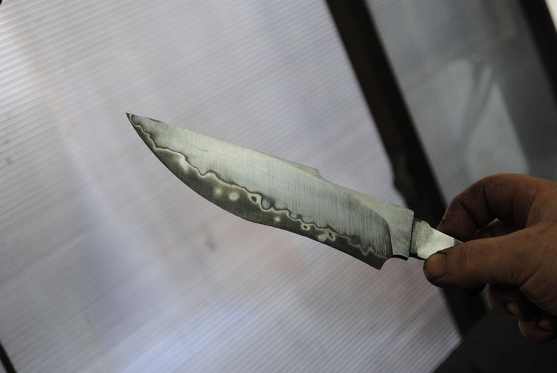

This is the teaser photo... As a maker myself this is one of the most exciting parts of working with SanMai and Hamon's, you get a peek at the patterns with every pass on the grinder!
a quick dip in the etchant to bring out the Pattern! I think we have a WINNER! Classic CAS Blade...

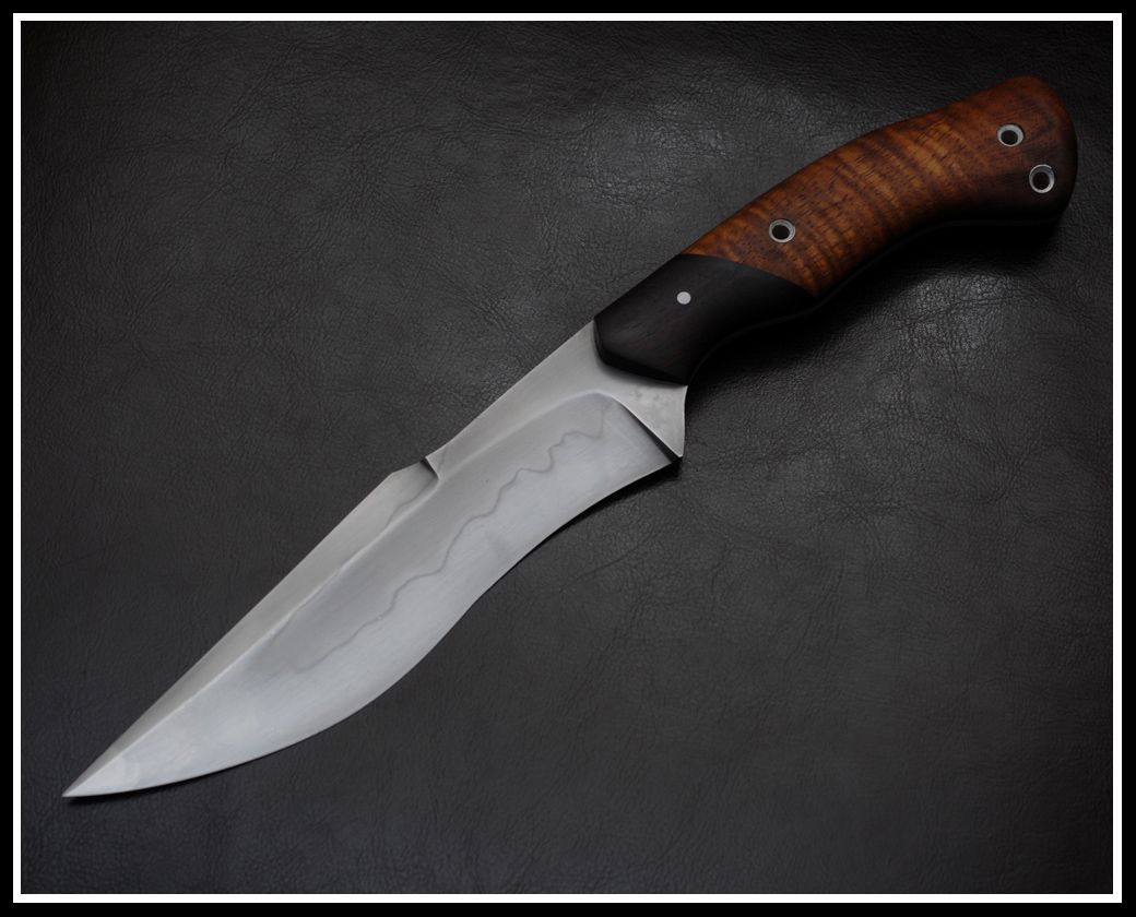

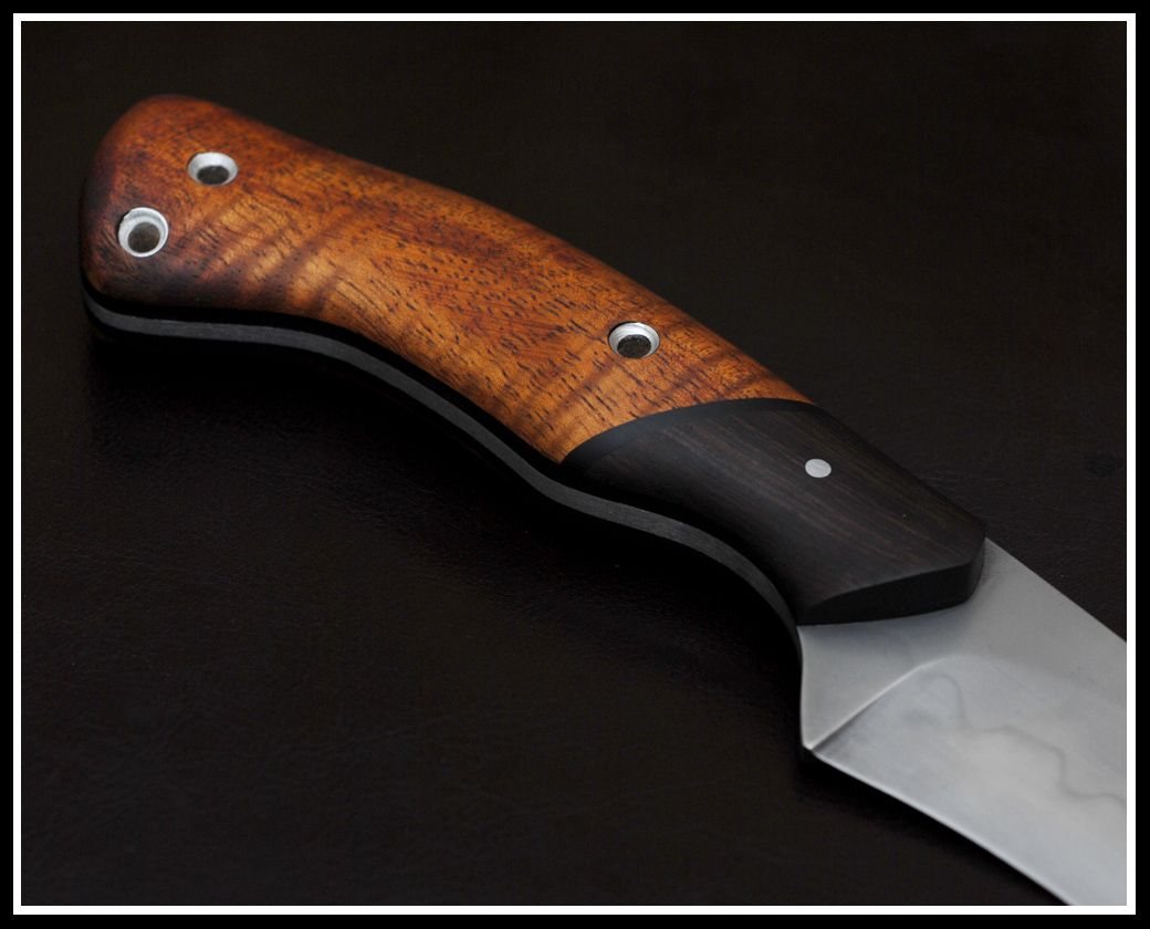

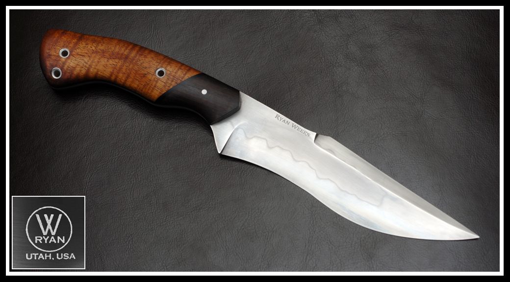

In the mean time, I have been working on the first design in this thread without the guard...
Billf's Fighter:
Steel: 1/8" 1095 (W/Hamon)
OAL: 12"
Blade: 6.5"
Handle: Stabilized KOA & Ebony with Black G10 Spacer
Misc: Tapered Tang (Slightly), Sharpened Clip, G10 Liners
I still need to work on the leather sheath but school was cancelled due to huge amounts of Snow (12" - 14" overnight) so I will most likely put that off and get some fresh tracks in with the kids :p
Design #1 turned out beautifully. Super excited to see this collaboration as well, excellent so far!
