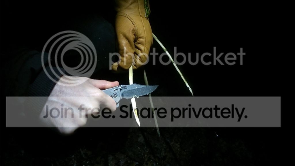

That isn't a choil. It's a grooved ricasso, which prevents you getting cut the way a finger choil would. This design makes sense to me because your finger isn't inside the plunge.
This is a big knife where you can also put your index finger right next to the edge for fine work. You just don't have to put it on part of the primary bevel.
Everybody can pick whatever kind of knife they want, but if the question is "is the finger choil the only way to get your index finger really close to the edge" the answer is "no". Finger grooves adjacent to the plunge and Scandi style handles do the same thing.
