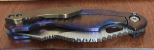

3155540D-8124-427F-9D68-64F2FF1F44EC.jpeg A306A5A5-EF1A-473D-B6C7-A858EAB88EF2.jpeg Update
I decided to go ahead and take the pivot out. Then I move the blade just a little bit back and forth, lo and below the detent ball fell right in. But now you can’t put the pivot collar back on because the front scale, the blade, the back scale are all out of alignment.
you can see in pict #2 the lock bar sit lower relative to the rest of the knife, fully closed and locked with detent ball in hole in blade. now if you pressed on the lock bar and try to pull the blade out IT WILL NOT come out
Compare that to Pict #1 where there’s no detent, you can press it with whatever might you possess and the blade can be EASILY PULLED out of the handle.
Pict#1 was taken in early PM with sunlight behind me
Pict#2 was just taken just now at 10 pm twith overhead light
Will try to get some more Picts later
View attachment 885435 View attachment 885436 Update
I decided to go ahead and take the pivot out. Then I move the blade just a little bit back and forth, lo and below the detent ball fell right in. But now you can’t put the pivot collar back on because the front scale, the blade, the back scale are all out of alignment. Now you can see in pict #2 the lock bar sit lower relative to the rest of the knife, fully closed and locked with detent ball in hole in blade.

I don't have a dog in this fight as I know neither party. But based on the latest pictures that the buyer posted and if these pictures are a genuine representation of the knife before and after, the knife itself is obviously defected. I just cannot imagine how @ShadyMethod, as a super active seller on this site, could miss something serious like that.
