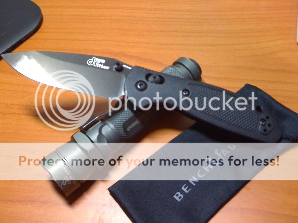

just got mine today
blade is slightly off center, which irritates me a little, and the coating doesnt seem that even, its glossy because i put on a layer of tuff cloth
Serial Number #144
Nice blade and sorry to hear about the alignment.
I had the same issue. But someone here once posted a fix to an off-centered blade that has always worked for me. Basically, you open the blade, put the side of the tip on a table, hold the handle with one hand and put a lot of pressure on the pivot with the other hand in the direction that would seem, intuitively, to make things worse. But it makes it better. My blade is now centered.
Twindog's solution worked for me. :thumbup: I centered my Ritter and Pardue large Grips. I couldn't tell which way he meant to push the blade but I tried both ways (pivot loosened) until I saw the centering happen, then tightened the pivot - voila!
