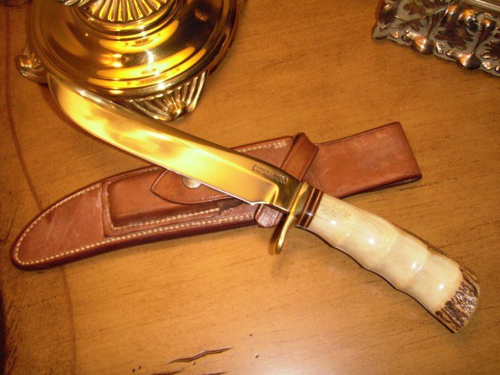

This is my latest addition.It was a standard 1-7 with leather handle and alloy pommel.
The leather and pommel had been damaged by leaking acid from a battery stored near it.
Damage was so bad the tang was visible for about and inch and a half!
I re-handled this with quarter inch thick pieces on black canvas micarta(14 and a half in all),I didnt have a block piece,the pommel from solid brass.
It went from being a write-off to a unique piece.I am happy with how it worked out.-Jay
I really like the way it turned out. Did you glue the "washers" together or are they just compression tight?

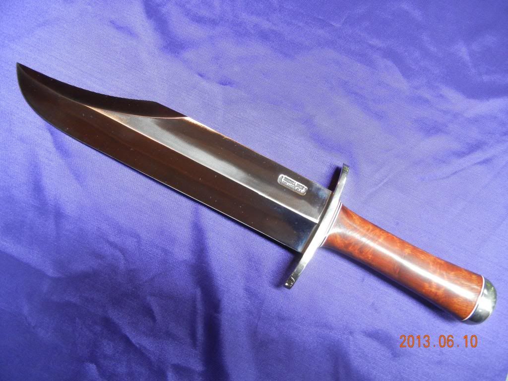

Since it looks like big Bowie's are in, here's mine. (by the way you can find it in the for sale section)
Dan in Sillycon Valley, KA
