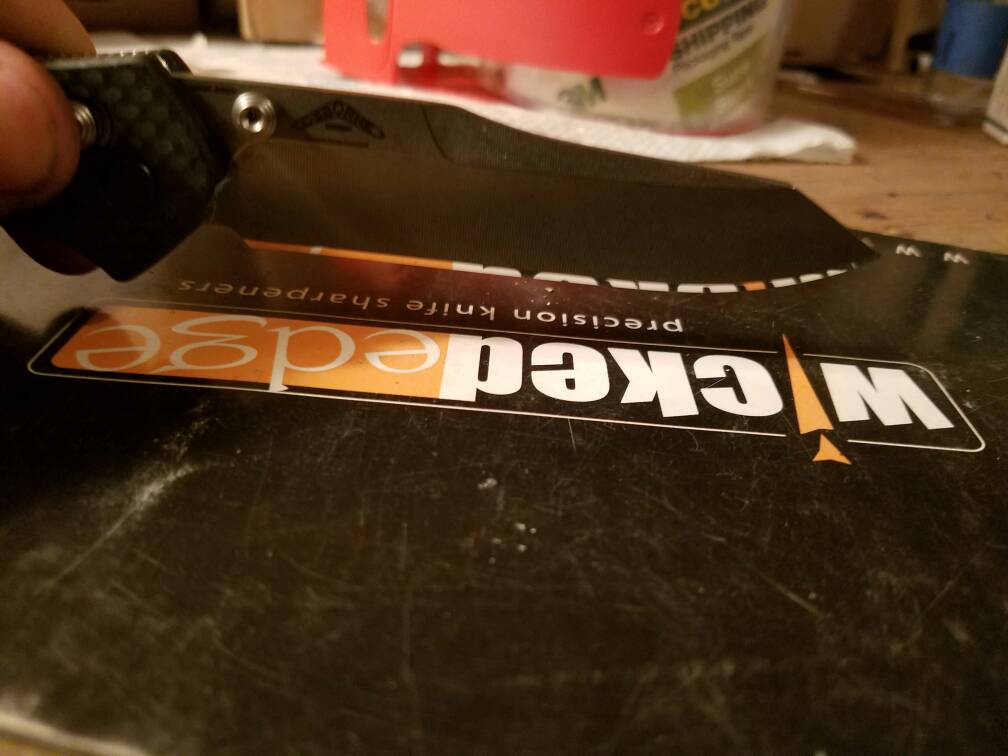

Super polished edges
3.5 xm18 20° per side, will drop it 17° per side or more next time when i have more time.

Beautiful edge, Bobby. I'm a fan of that natural/Jade G10 too.:thumbup: Is there a micro bevel on it?
Thanks bud, and no its currently at 40° inclusive. (From 54°) i didn't have the time to keep grinding that 20cv down to 30-34° lol figure the next session I'll finish it off. Still plenty sharp thou.
And yea I've been on a jade/ natural g10 kick lately lol. Just digging the look.
