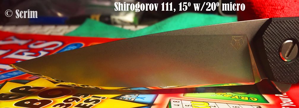

I have sharpened or touched up all my 5 Shiros. I started out at 20 ps on the SharpMaker, and all but my 111 touched-up/re-sharpened very easily, so they would seem to be at or slightly less than 40 inclusive.
The 111 was considerably more obtuse and I wasn't going to get anywhere re-profiling that M390 on the SM, even with the diamond hones. I wanted to try a compound edge on the 111 as mine has the fuller and is not full flat grind, but was concerned about making the edge look too broad as Shiros look so sweet with their narrow bevels. I went ahead anyway, starting at 15 ps with the 220 hones on the EdgePro. I took it up through 400, 1000, and polishing tapes and finished up with a 20 ps micro on the SM and a green-loaded strop. The edge does look broader, but not overly so to my eye, and is scary sharp.
Sweet edge, Scrim. I remember that pic from back at Page 1, and it's nice to see it again.

ChazzyP, Thanks...and I think so but don't remember for sure (pivot bushing). I sharpened this one a while ago and many knives since, so I'm a little foggy on that detail. I'd open her up but everything is working so perfectly, and she's blue loctited...so I hate to open her up just to take a look. I don't want to mess with what is currently, perfect action. I do remember how very thin I thought the washers were on this one when I first opened her up, shortly after I first got her, maybe two years ago, approx. Odd, the things that stick in your mind. If she ever again gets sticky or gritty or in any way imperfect, and I HAVE to open her up for cleaning, I'll let you know if there's a bushing in there or not. Damn, should have taken some pics while I had her open. (PS. Oops, I completely forgot I posted that 111 pic to pg. one of this thread. Sorry for the repetition.)
