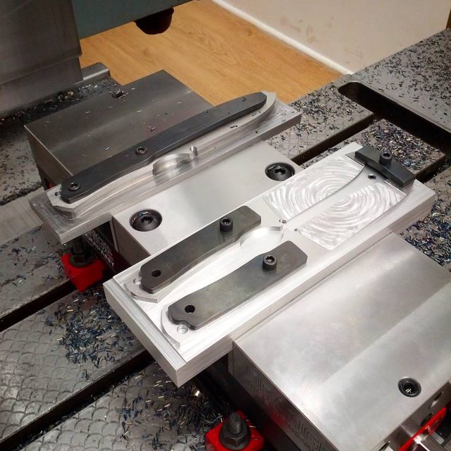

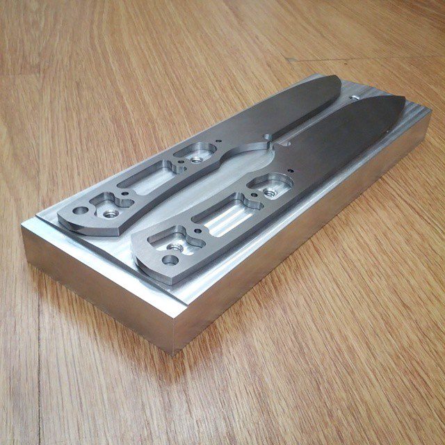

For the last 2 days I've been working on a fixture and toolpaths for partially milling the bevels on the machine! Easily the most complicated fixture I've had to make so far, simply because the angles and overall positions need to be incredibly precise. I used a large angle table to set everything up, here you can see the setup I used for milling the angles onto the fixture:

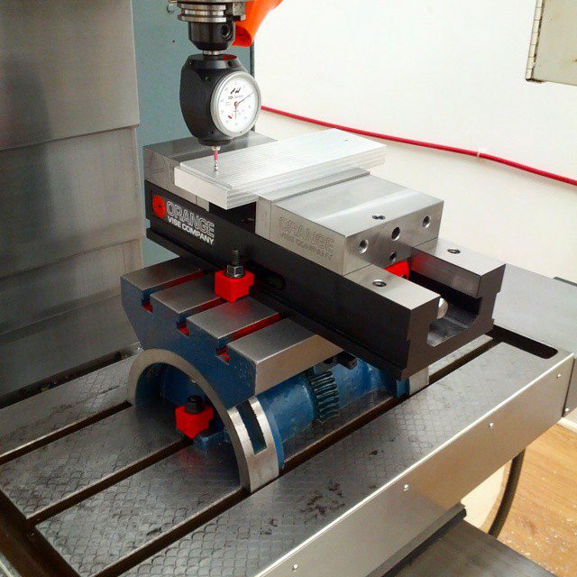

The angle table was probably a mistake unfortunately. Its adjustments are far too coarse to be all that useful. I ended up dialling it in by using my Haimer indicator to measure the slope across a 1" section of the workpiece. This got me very close but in the end I had to make some adjustments by lapping the back of the fixture and focusing on one side. I removed about 0.0015" and it's very nearly perfect now, I think I need to remove about another 0.0005" and then it should be good! This is what the final fixture looks like:
The fixture is mounted in the vise, then clamps go over the top of the tangs and tips of the blades to hold everything in place. The bevels are machined in a spiral pattern starting right in the middle where the material is weakest, that way the remaining material is still there to support it. The tool then works its way outwards to where the material is best supported. Seems to work very well!
The main point of doing this was to make it much easier to get the plunge lines perfectly consistent. We all know how much of a pain that can be and it really wasn't something I wanted to have to deal with on potentially dozens of knives.

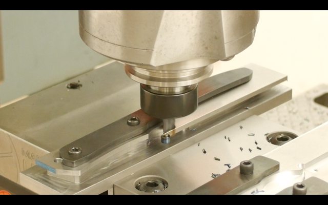

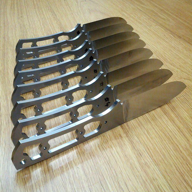

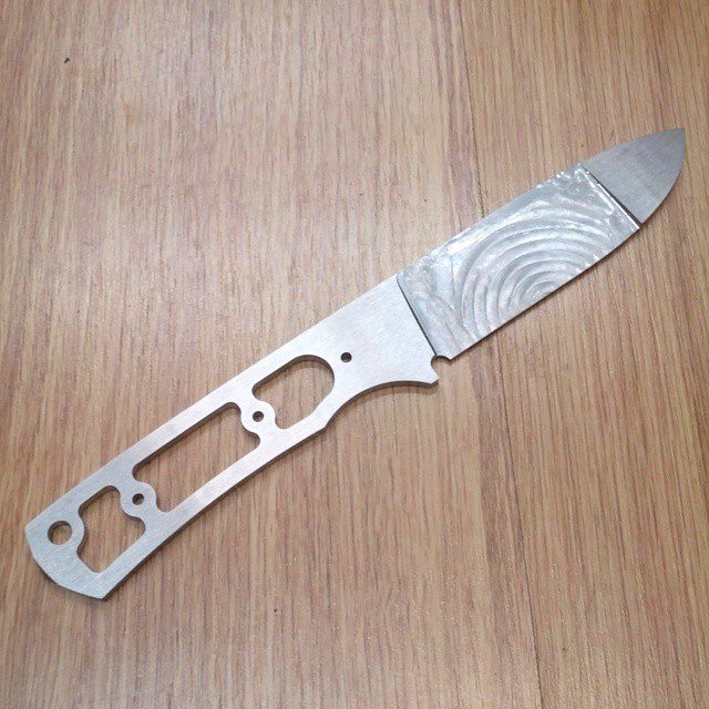

After much tuning of the fixture and toolpaths the blades are coming out quite nicely! Took me seven attempts to get to this stage:
To some extent I'm a little amazed that it actually worked! The edge is only 0.012" thick so it was an open question for me whether it would simply get deflected and chewed up... Seems the tactic of starting right in the middle works very well!
The spiral pattern is something you can see, but not really feel at all. Feels very smooth to the fingertips. I have to finish the tip of the blade on the belt grinder anyway, so when I'm doing that I will do a quick finish pass over the rest of the blade to blend everything in, should work out well I think!
I'm pleased with the process I'm making so far! I still have to finalize the bevel jig, then I need to work on optimizing the toolpaths for the handle scales, then I'll be onto working on the sheaths!

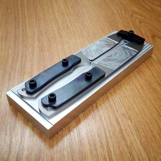

Today I finished up machining all the clamps for the bevel fixture:
The tang clamps are bent about 0.050" near their tips to ensure they press down as closely to the plunge line as possible.
The tip clamp is quite stout at 1/4" thick and only 2" long, I had to heat it to 1700°F before bending it! The tip clamp is machined on the underside to provide a recess so that it sits on the blades in a specific location, without that the clamp would be easy to misalign and it might get in the way of a tool!
The two tang clamps are made from A2 and the tip clamp is made from 5160. All were hardened and then spring tempered. Bit of a time consuming thing, but it will hopefully make them last forever!
The fixture now consists of 4 unique components (not including the fasteners), in total the parts required 11 separate setups to make and most setups had 3 or more machining operations... All told this fixture has taken me about 2-1/2 days of work. Still not as quick as I could be on the CAD/CAM/Machining cycle, but I'm getting there!

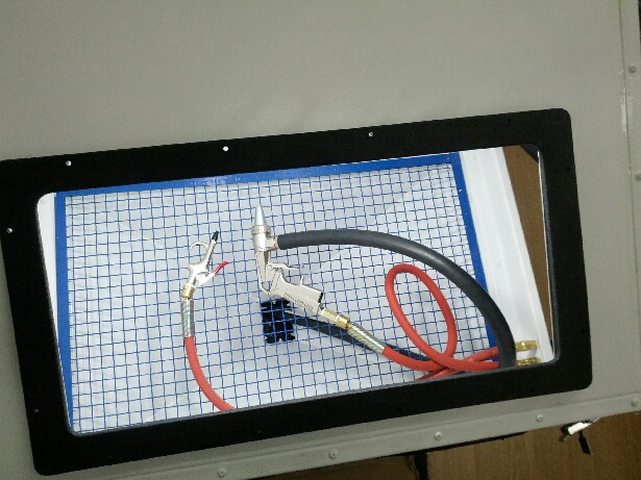

I've spent quite a lot of time over the last little while making new equipment. Been working on a custom sandblasting cabinet that should make prepping for Cerakote much more pleasant! It has 3000 lumens of LED lighting in it, a nice blasting gun and also a blow-off nozzle in there. The inside is lined with white plastic to make it easier to see everything (and the plastic won't wear away like paint would). The glass window will be protected by a very fine stainless steel mesh rather than the usual peel off plastic... Apparently they use the mesh method on some high-end cabinets and it's supposed to practically last forever, we'll see how it works out!
Here's a view inside the cabinet as it stands at the moment, still have to add the window and mesh:

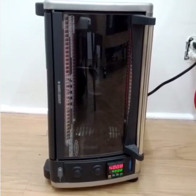

I also built a small PID controlled oven to cure the Cerakote in, basically just a toaster oven retrofitted with a PID controller and a solid state relay:
I was hoping to be able to use it for tempering as well, but I don't think that will work out. This oven is a little small for the job, but it will do for the moment. I will scratch-build a larger oven once I'm up and running.

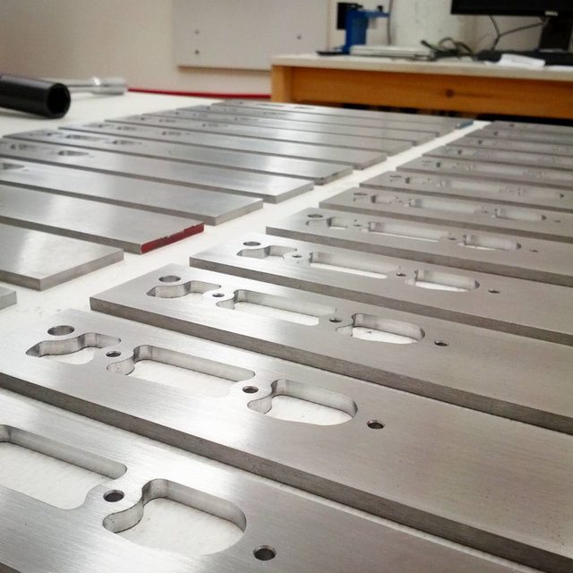

As of Thursday I have officially started my first production run! Pretty exciting! I'm doing 24 knives in the first batch. Here you can see the first stage:
After that step they are placed into the fixtures for operations 2 and 3: profiling the blade, and then roughing out the bevels:
After the bevels are roughed out they're finished by hand on the belt grinder. Doing operations 2 and 3 in one go gives me enough time to do the grinding while the machine is finishing the next knife, works out very well!
The profiling operation turned out to be the trickiest one so far. Basically because I'm machining a thin material that's not ideally supported. To help this I had some custom tools made. These are 'downcut' endmills (left hand spiral, right hand cut) which push the material down onto the fixture rather than pulling it up. Before the chatter (material movement) was destroying the cutting edges on the tools very quickly, I was only getting 3-4 blades from one tool!

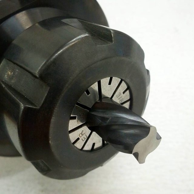

The length of tool I ordered ended up being too long so I had to cut them down to just 0.4" of flute:
(EDIT: tool is further in the collet than would usually be wise here, I had to really shorten up on it to combat chatter. Seems to be working ok so far!)
Did this with a dremel and a diamond cutoff wheel, bit finicky but worked very well!
Using those new tools in combination with a new toolpath seems to be working very well. Before I was cutting at the edge of the material and working my way inward (high speed machining) which was destroying tools because the edges of the thin material was moving up and down and chipping the tools. Now I'm just digging right in and tracing the outline of the knife in a 'slotting' operation. This ensures that I'm always cutting the material where it has the most support. I've already cut 10 blades with the new tool and it still looks brand new! I'm hoping tool life should be more like 50-100 blades per tool now (at the least!).

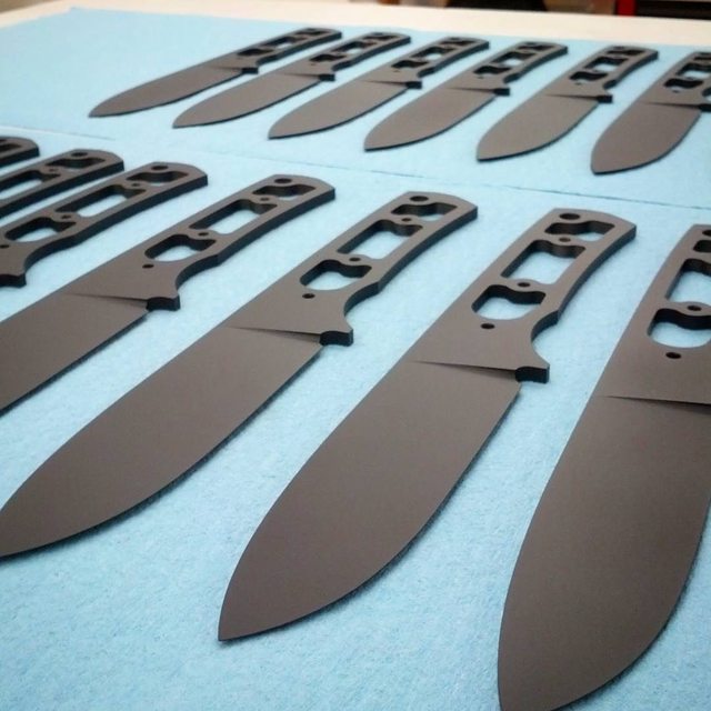

Well the first production batch is now rough ground and heat-treated. Today I'll be working on finish grinding them to 180 grit. Normally I don't grind after heat-treat, but the 120 grit turned out to be too coarse for the Cerakote, grinding marks are still showing up through the finish. I bought a bunch of 180/220 grit Aluminum Oxide belts that I can run wet for the finish grinding so as to avoid any temper issues.

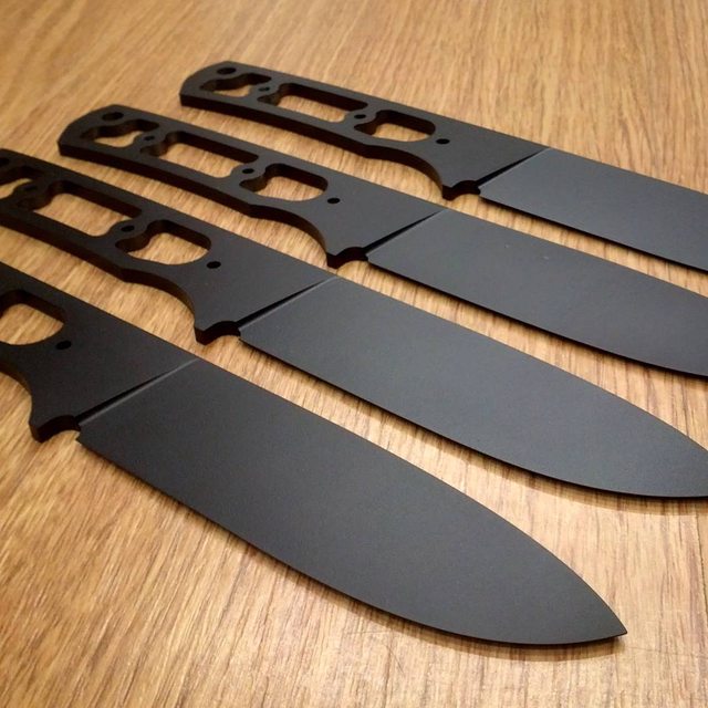

The prototype batch has been sandblasted and sprayed with Graphite Black Cerakote at an 18:1 ratio. The HVLP gun was set to a very low airflow and a 3" wide fan pattern at about 6" distance. The new Iwata gun I bought from Cerakote is beautiful and very easy to setup and spray with!
Sandblasting the blades in in credibly tiring, I'm going to be modifying my blasting gun so that it's attached to the cabinet and always on, that way I can manipulate the blades with both hands in front of the gun, rather than having to manipulate both the gun and the blades... Should make life much easier!
