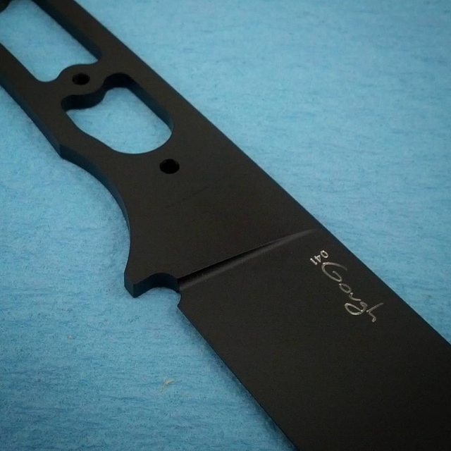

So yesterday I focused on getting my engraving sorted out:
This was done with the tip of a Maritool 3/8" diameter 60º chamfer mill that I use in another operation for cutting the window-breaker on the butt of the knife. I originally tried to use a separate tool but the other tool had too wide of a tip and made really awful looking engraving!
On this batch the engraving itself was a pain to do because I had hand finished the blades which meant the thicknesses varied quite a bit. I had to set the Z axis height for each one individually and it took a while!
The next batch will be much more consistent in this regard so I don't think it will be an issue. If it does continue to be an issue then I will switch to using a spring-loaded engraving holder. I'm hoping to avoid that though as the spring loaded holders seem to produce less nice engraving from the photos I've seen.
Pretty happy with how they turned out! Today I'll be working on handle scales!

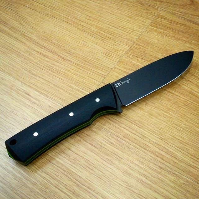

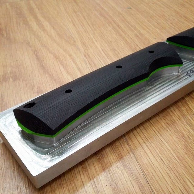

Had a pretty big milestone yesterday! First I machined the first production scales:
And then I assembled the first complete Resolute MkIII!
Very pleased with how it's come out! Fit and finish of the tang to the handle scales is bang on. Very, very close to being the same as if I'd ground them together after glue-up. Consistency of the finish on the edges of the tang is simply way above anything I can do by hand, same with the window-breaker and finger groove details.
Very very pleased that it's come out the way it has!
This knife is actually a 'blem' (plunge line has a mark in it on one side) and will end up being my personal knife. I'm taking tomorrow off to head up to a friend's cottage, will spend the time doing some carving and so on with the new knife, looking forward to it!

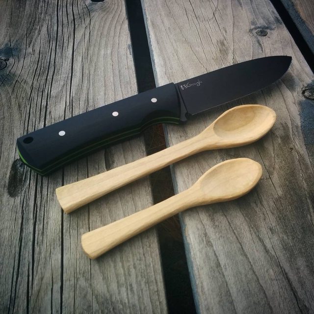

Spent the weekend up at a friends cottage, did a bunch of woodcarving while I was there!
These were carved from dry poplar. very happy with how the knife felt and performed. Spent about 4-5 hours with it in-hand over two days. No hot spots, no blisters. The knife is also still shaving hair nicely.
Very pleased overall!
