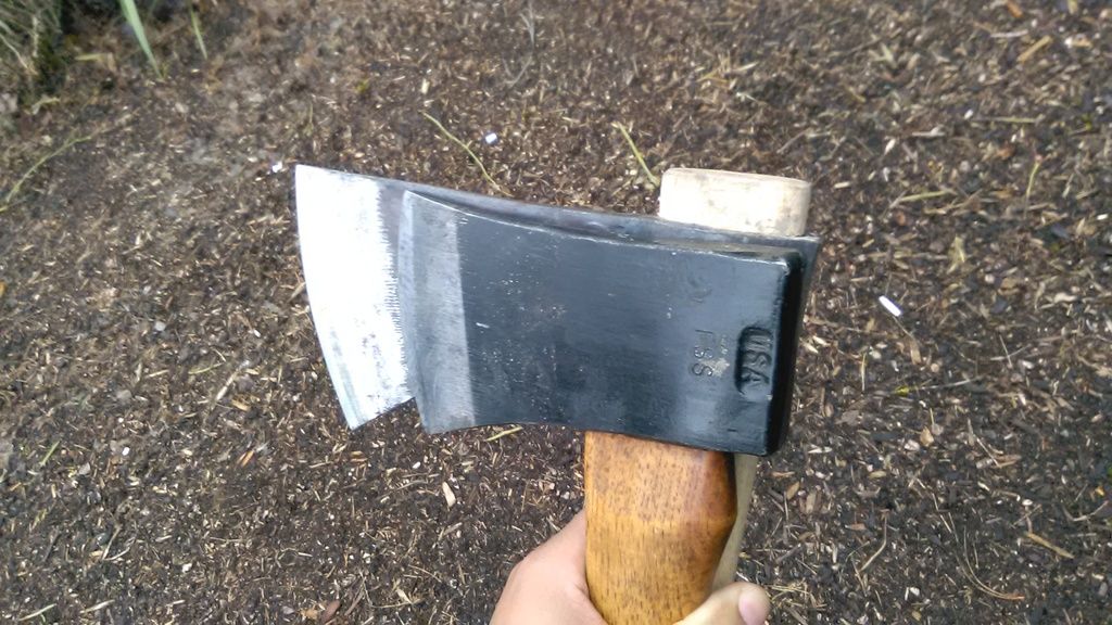

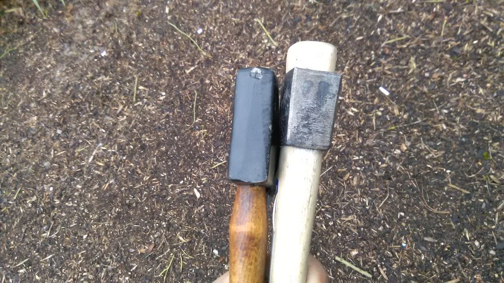

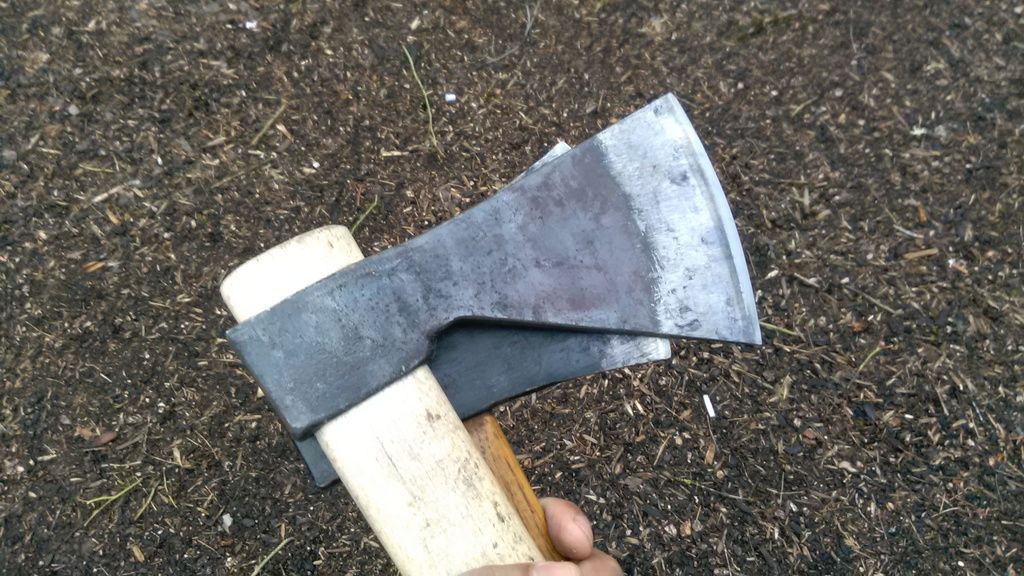

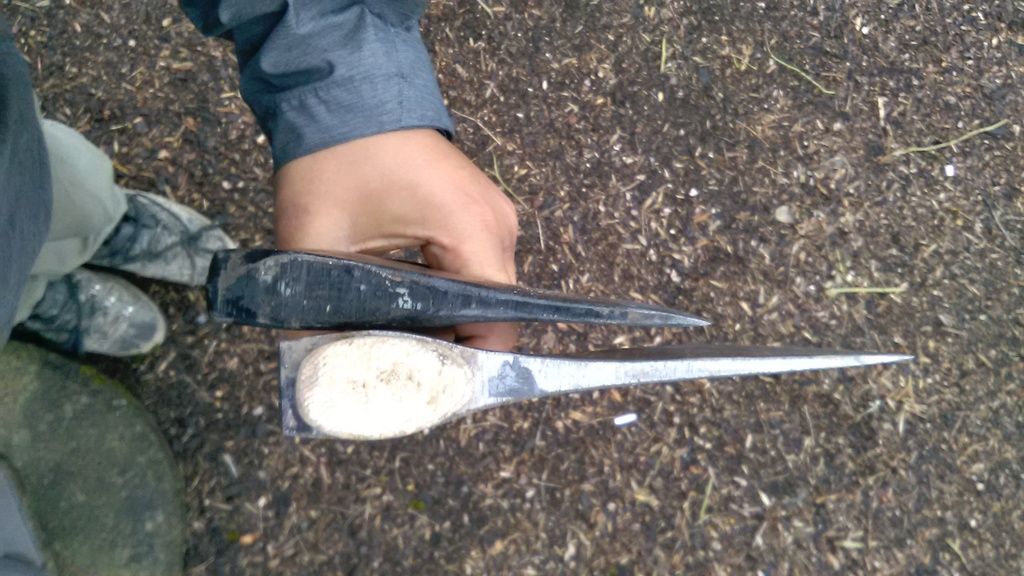

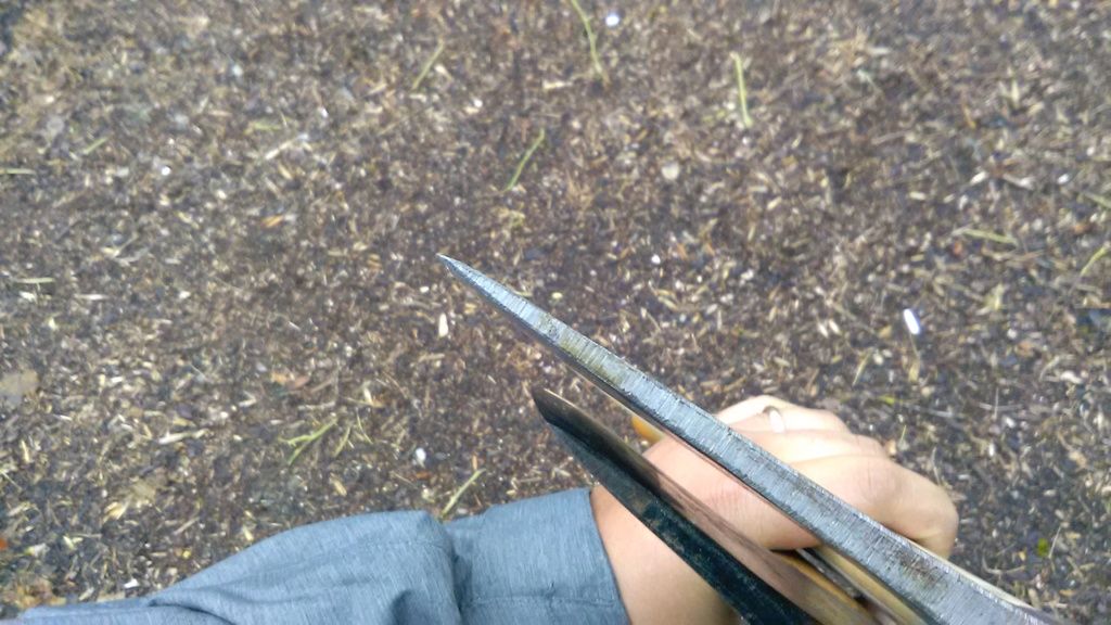

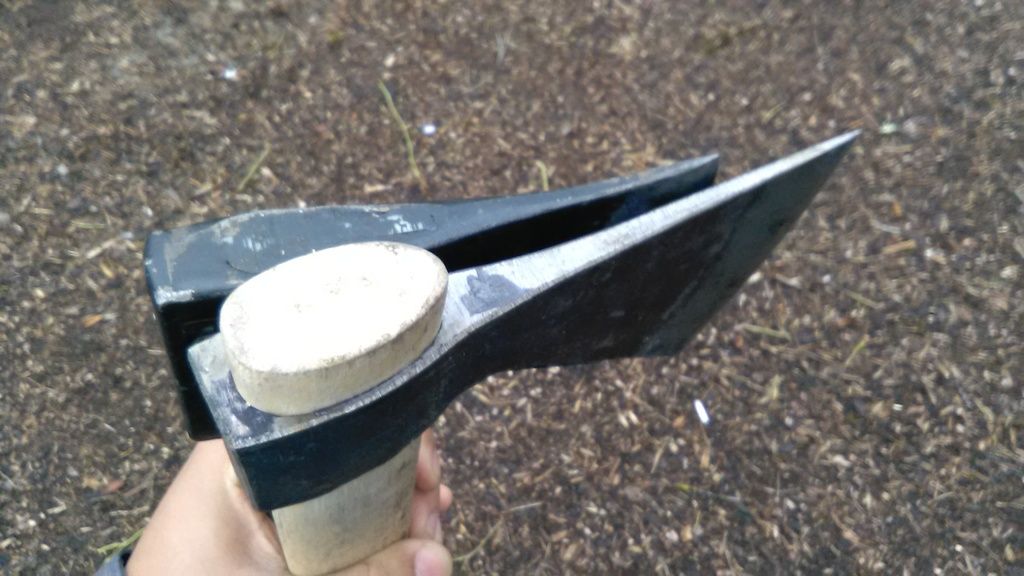

Can we see a comparison of the bit geometry of the two axes side by side?
you got it

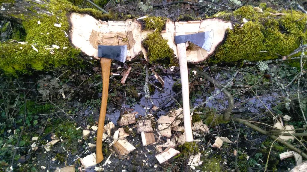

If I'm not mistaken, the Council has an extra 3/4lb of steel in the head compared to the Rinaldi, yes?
Feels like 1/2 lbs difference

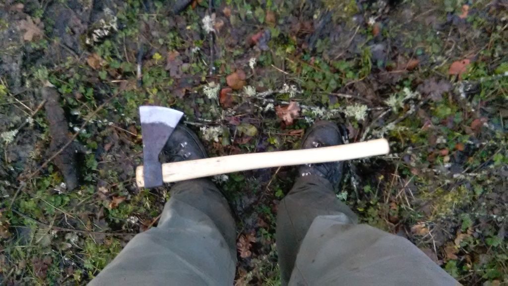

Regarding the weight of CT boys axe, there's a review online where the head came off (I think) and was weighed at 2#. That seems reasonable to me as the CT boys axe felt light and similar to the Hudson bay which is supposed to be 2# in its current incarnation. I gave the boys axe away, but was impressed at its thinness and "bite".
I've really been enjoying the lightweight portability of this axe
I really feel like it can go anywhere with me yet I don't feel "outgunned" when I need to get some serious work done.

I am surprised by how flat cheeked the Council is. I guess I have just had older ones. The Italian head looks cleaner with more attention to the finish grinding.

I've really been enjoying the lightweight portability of this axe.

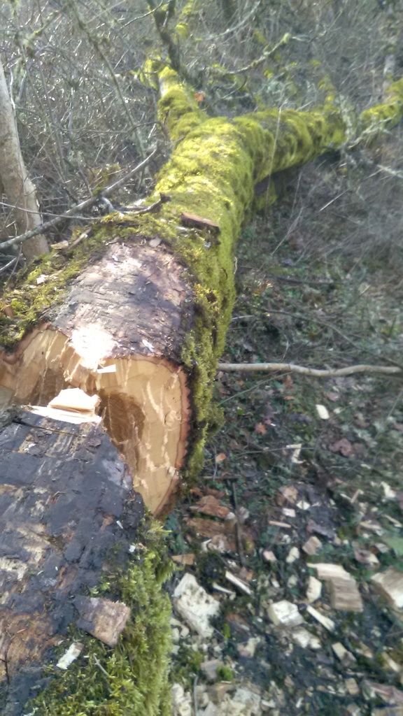

You are a strong and energetic young man. But your really are outgunned chopping that size tree with such a light axe (regardless of the style or where it was made). With a full size axe you wouldn't need to increase the width of the cut - twice. And with a longer haft you wouldn't have to bend down as much and that would give you more wind. The bending constricts the diaphragm.
There's no doubt that little axe is doing the job. It's performing well above what I expected. I think it would compete well with the offerings from GB.

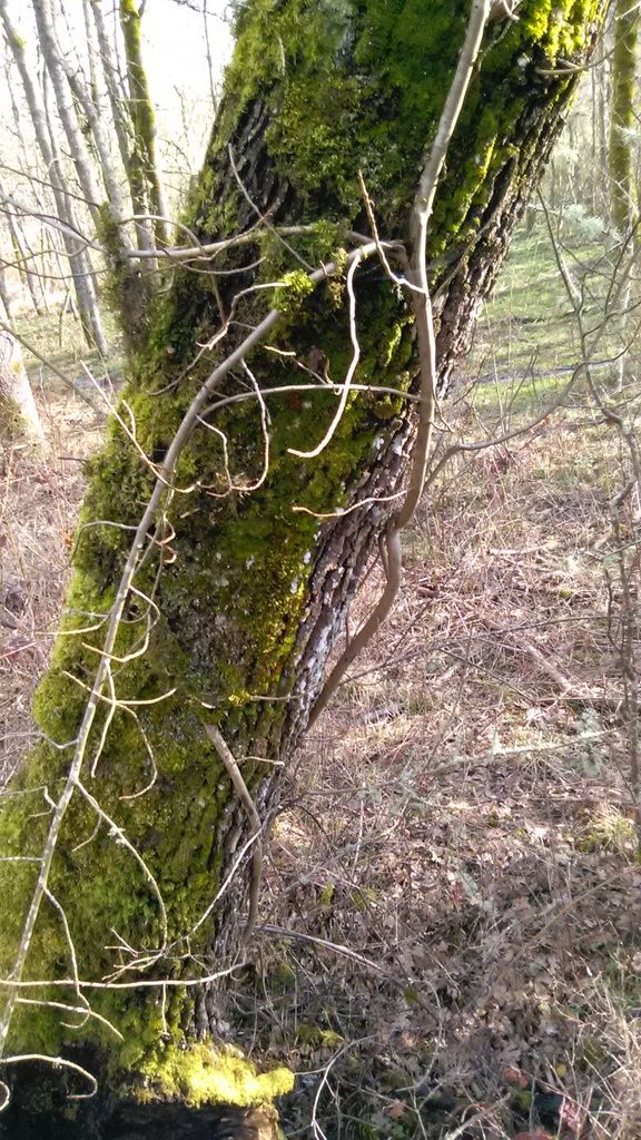

This is true, but I do this to show the performance, the GB SFA cannot compete with the RAB, but the GB SFA is a better "product" ( nicer handle, steel, sheath, etc) but the RAB has better performance.
That brown heart wood was hard as a rock, I honestly thought the bit was going to break.
it made a high pitch "clink" sound on impact but I kept at it, hitting it as hard as I could, really had to work at it to pop chips.
No edge damage to my surprise.
I stopped and looked at the wood grain, very swirly
Thats when I knew this wasn't cottonwood.
Some kind of oak.
That's along ways to be off on a boys axe and would be noticed. I like the cruiser weight a little better and that is 2 1/2lbs so it's just a little step up but you can feel it. Them old military surplus Swedish axes are even more useful and they are 3lbs on a boys sized haft. The couple I have owned were both on the soft side of things though. I still have one but I probably won't hang onto it. I just really liked the size and weight.

I don't know for sure, and not the one I was remembering, but this review explicitly states 2#.
http://woodtrekker.blogspot.com/2011/06/council-tool-boys-axe-review.html
Either way it was a nice little axe and seemed functionally equivalent to other boys axes, but I usually use a 3.5# when I'm not sure what I'm going to be doing and might need it, so I didn't push it too hard for the few weeks I had it.
