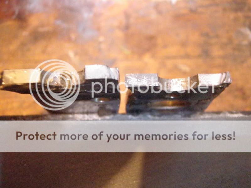

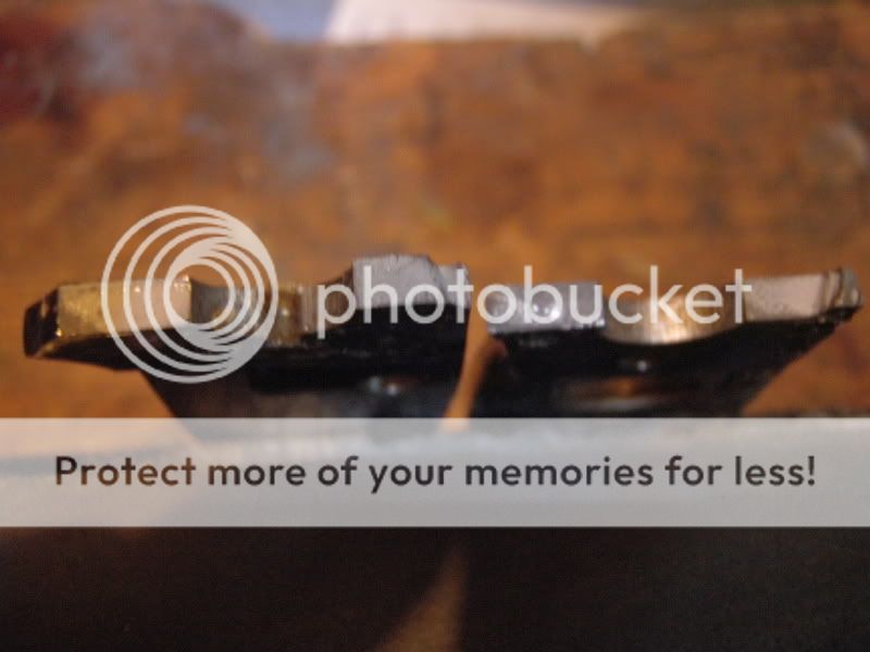

now,My camera is having a hard time with the super macro shots of the broken edge.I did get these 2 shots though.

Those holes look milled and not drilled?
Irregardless, any holes in the tang should be deburred/polished and chamfered.
Machine marks are stress lines........like scoring a piece of glass.
I'm no knife maker but I've built enough racing engines to have seen what and where steel fails under stress. With a proper hand finishing in those areas it probably wouldn't have failed/

Looks like a flaw in steel that acted as a stress riser.
This could happen to any knife by any maker.

Thanks for the pictures, I study materials science and was hoping to come to some conclusion about the failure. There's a small white speck in part of the blade, that could well be a void that acted as a stress raiser as Big Mike said. It's hard to tell without a decent look at it under a microscope or in person, but fair ideas can be had about the failure mechanisms from the images you provided. It's interesting to notice that what I think is the ductile area of failure (the big spur at the top), where the fracture would have initiated, is in the area that was closest to the plank as you were batoning. In this sort of impact loading, once failure has initiated it's only a matter of time before the object falls apart.
There are a few other possibilities, but a stress raiser seems most likely assuming the steel was properly heat treated, not below its embrittlement temperature (which according to my software is -53 celsius/-63 Fahrenheit), not being struck with an object close to its own hardness and that the knife did not already have a crack from improper cooling.
Good luck getting this sorted with spyderco, I'm sure they'll do right by you and I hope you're not knifeless for too long. To make the lab's life easier be careful when you send the knife off, as fracture surfaces are very delicate. Make sure the fracture surfaces are not touching and cannot be abraded during transport. I would suggest you tape the pieces side by side to a piece of card/carboard/plywood and then secure another over the top. This would create a sort of blade sandwich, protecting everyone else from the blade and the fracture surfaces from everything else.

I have to say I'm a little concerned that the skeletonizing holes weren't beveled, and that there is one so far forward. I've got one of these knives that needs a little fixing - the scales have pulled away from the tang on the front end - and another on the way.
