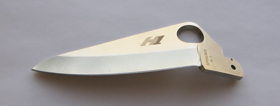

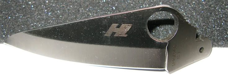

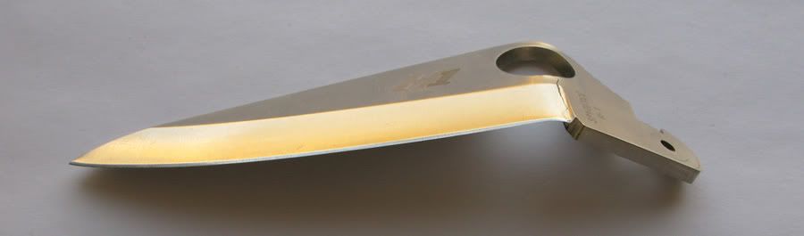

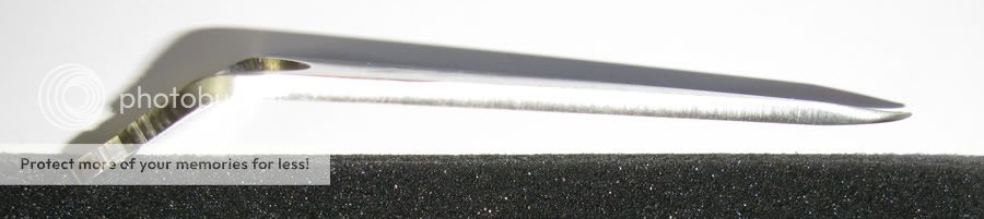

H-1 though not as wear resistant as many of the other steels has its advantages with regards to Corrosion Resistance and toughness.
H-1 bends (plastic deformation) instead of breaking.
